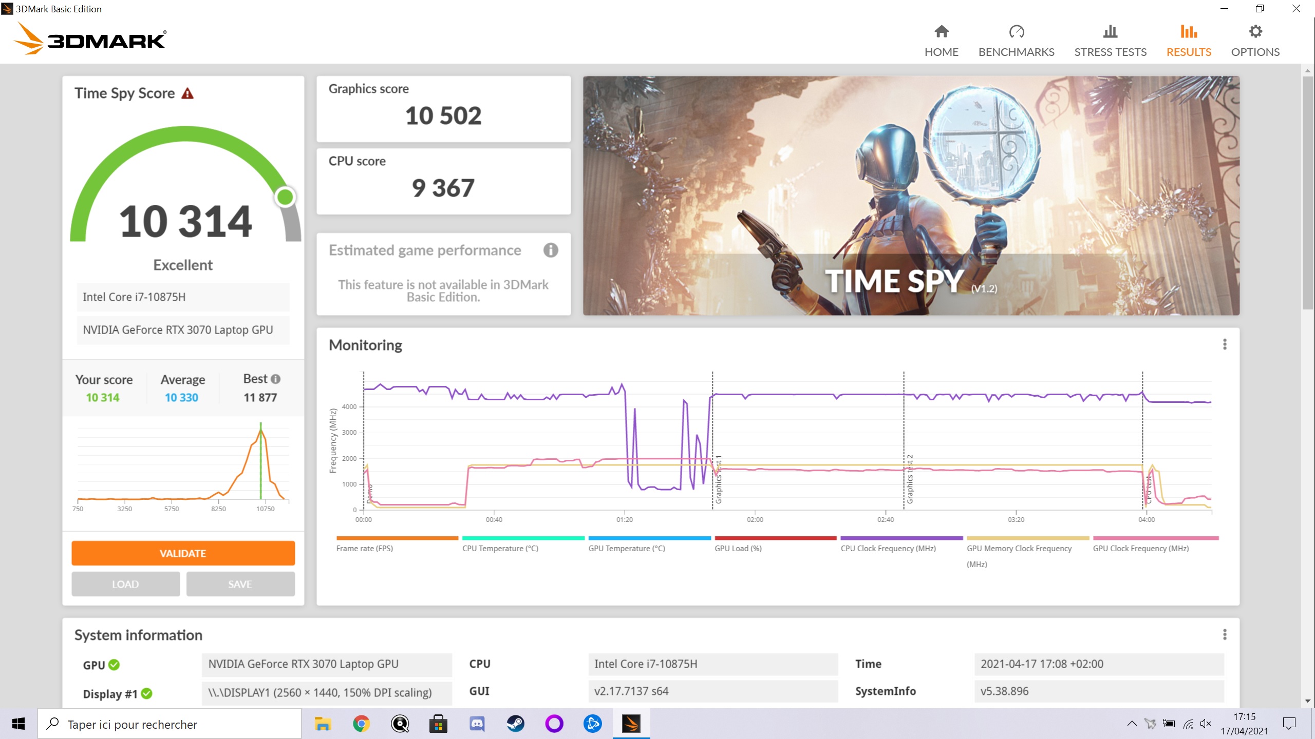

Please find below some benchmarks (all the benchs with the following CC setup (CC 3.9.18.00 : default overboost setup + unlock configurable TGP : 140 W, dynamic boost desactivated, CPU undervolted at -100mV) :
GPU not undervolted, not overclocked :
GPU undervolted at 950mV, not overclocked (below 950mV, I have an error message) :
GPU undervolted at 950mV, overclocked at +150MHz :
GPU undervolted at 950mV, overclocked at +200MHz :
  • Time Spy_140W_Undervolt CPU_Undervolt GPU 950mV_Overclock GPU + 200MHz.jpg
