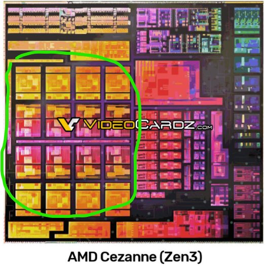

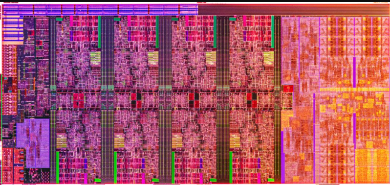

If I were you and had to buy now, I'd go 5900HX unless hundreds of EUR more. About CPU, In gaming they are in the same ballpark, but for anything else AMD is better.
I'd cheap out on the GPU though (3070 is enough, 3080 too much cost per performance).
Please just note that since a lot of die space in Zen3 is occupied by the L3 cache, the 8 cores are all crammed together -> a lot of heat generated in a single part of the die. It is VERY HARD to pull out heat from there, unless you go Liquid Metal (a thing very hard to apply and not being offered by PCS). Intel Cores occupy like 60% of the die, Cezanne no more than 35%-40%:
Intel 10875H
This means you might see 95C while gaming on AMD (aka throttling), unless you apply LM with all the precautions by yourself (you need to isolate a lot of circuitry over the die to avoid them touching the LM else bye bye laptop, etc.)
Still, for productivity tasks it seems a lot less hotter than that.
Given the above I'd go for a 17 inch sized if going AMD, instead of 15, at the least. Bigger side radiators, easier to remove heat at the least.

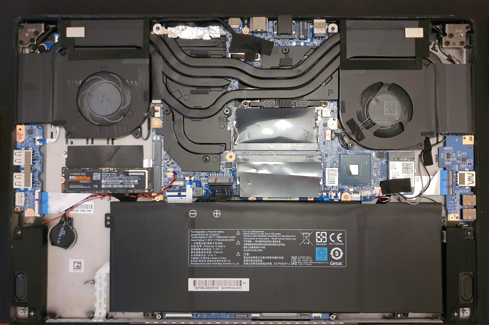

In all all honesty, the only minor question is: being TGL a 10nm die, vs the 14nm die, how large it is? How easy is to remove the same heat produced by the same 45W TDP than 10th gen?
We actually don't know. You should stick with looking every day at 3DMark until someone publishes 11800H benchmarks so you can see the temperatures and compare I guess.
Still, being the motherboard the same, I expect the CPU package and heatspreader being the same, so as large as the 10th gen. It's the die inside pretty small.

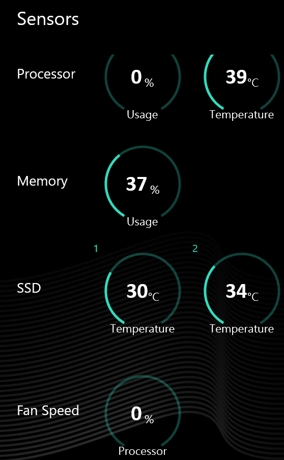

Just to add some testing about Battery operation I've found that for office works the Laptop is very well suited under these particular conditions:
  • iGPU only set via BIOS (it turns off completely the Nvidia GPU; it should be similar to Nvidia Optimus without the risk of turning it on due to some nasty program here and there)
  • reduced screen refresh rate of the panel in Windows Settings. This panel has only two native Refresh rates available: 165 Hz and 40 Hz. While 40 Hz isn't great, it's enough to give pleeeenty of juice at Office work. Also, watching YouTube isn't bad at all, even if it does not cover the full 60 FPS the majority of videos offer.
The above settings plus the normal Office mode in Control Center, keyboard lighning turned on but at low level and timing out after 10" usage, Windows battery slider set to Better Battery (it could go even further in Battery Saver) allows to consume like 43% of the battery in 3h 8 mins of usage.
A usage that, as usual, is pretty office oriented: MS Word, Excel, Outlook, MS Teams, Chrome, Edge Chromium, Citrix Receiver, PDF editor, and so on.
This from the Batteyreport Windows creates by invoking powercfg /batteryreport (I've turned on the laptop at 13:19, worked on another PC until then; it entered standby for 1 minute while I was AFK during this testing).
2021-06-0408:00:50ActiveAC100 %91.245 mWh
08:33:00Suspended100 %91.245 mWh
13:19:33ActiveBattery100 %91.245 mWh
13:50:52Suspended92 %83.945 mWh
13:51:47ActiveBattery92 %83.945 mWh
16:27:27Report generatedBattery57 %52.010 mWh
Also seen as this (another generated report after a while, at ):
START TIMESTATEDURATIONENERGY DRAINED
2021-06-0413:19:33Active0:31:198 %7.300 mWh
1 min standby (note by myself)
13:51:47Active2:53:1939 %35.585 mWh
the battery consumption, if estimated correctly until fully depleted at 0%, would be a whopping 7 h and 17 minutes.
(3h 8 min / 43%).
Not bad for a 14nm CPU gaming laptop I guess. It sips power.
Oh, and all this with a fully silent laptop: check the 0% RPM fan! (dGPU fan not appearing as I totally disabled it in BIOS). This while I am writing this:
