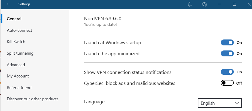

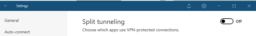

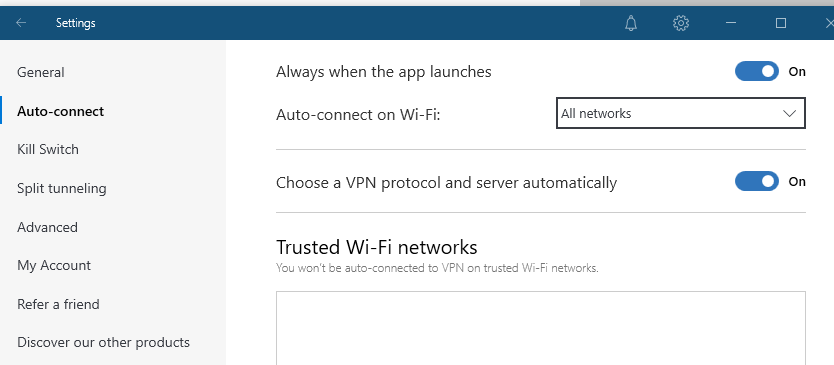

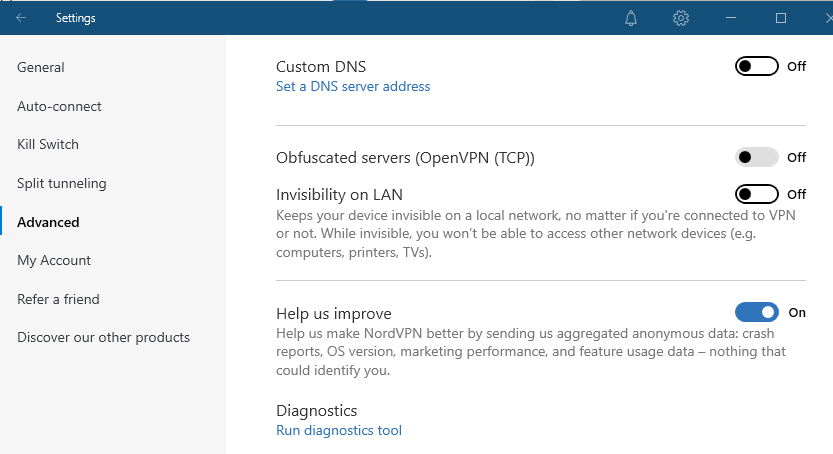

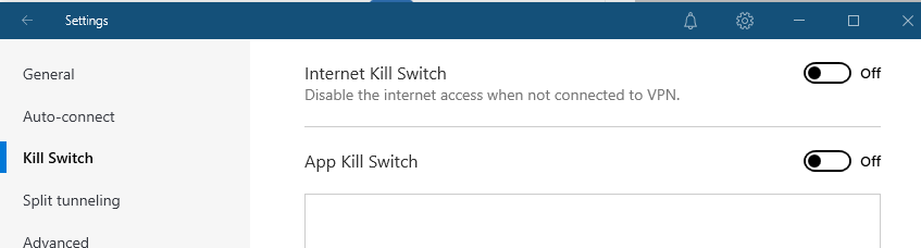

Thanks for the info @SpyderTracks, apprecviate you taking the time to explain, I switched from PIA to Nord as I found PIA caused issues in all sort of scenarios, for example paying for anything on line meant I had often had to disable the app and reload the browser which was far from ideal. I did a little research and switched. Nord has been much more seamless in use apart from this initial start up issue. My settings are -
Thanks for the info @SpyderTracks, apprecviate you taking the time to explain, I switched from PIA to Nord as I found PIA caused issues in all sort of scenarios, for example paying for anything on line m,eant I had often had to disable the app and reload the browser which was far from ideal did a little research and switched. Nord has been much more seamless in use apart from this initial start up issue. My settings are -
