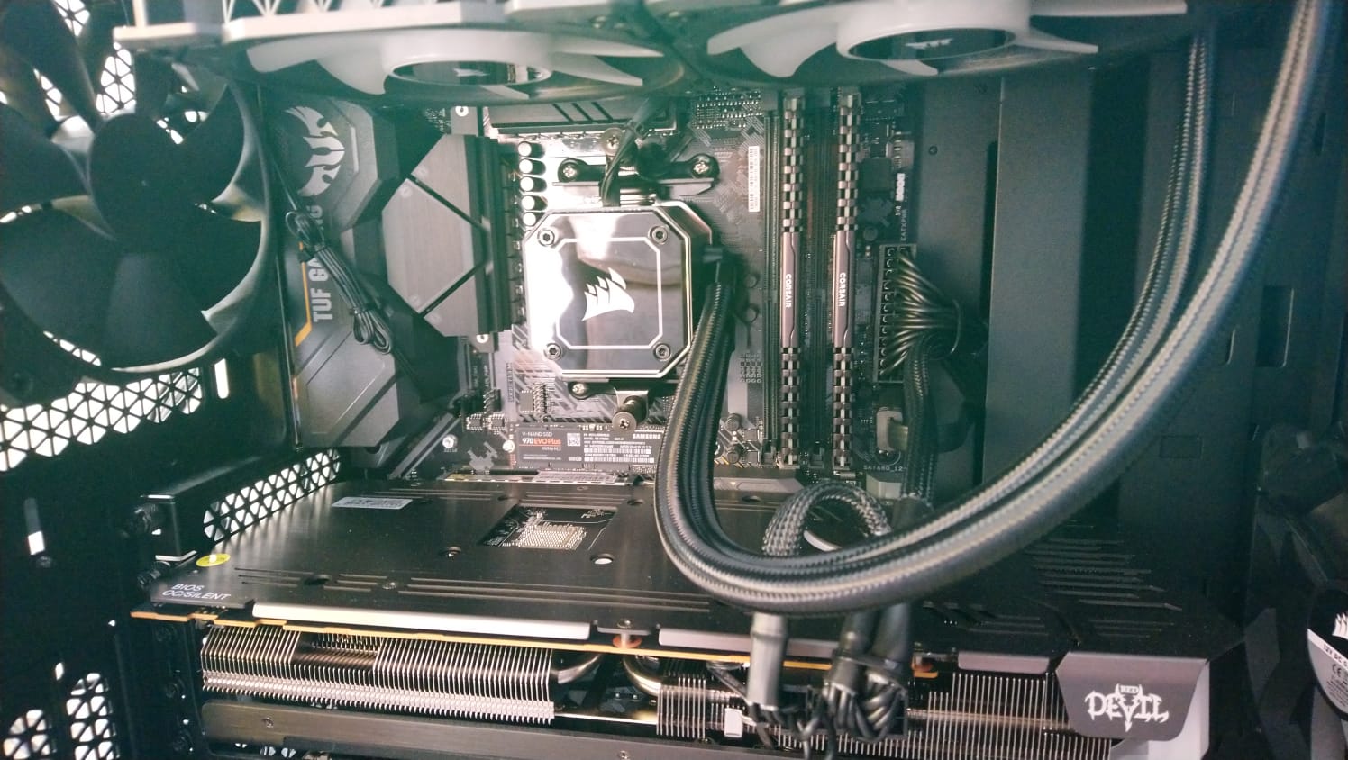

That's true but apparently it was lighted up before. I'm a bit confused now. Could it have been the light from the motherboard which isn't right now?
I'm not that familar with your motherboard, but I don't know which light from have been lit previously that isn't lit now?
Could you post a photo of your board and RAM and we will hopefully know for sure once we see it.....
NoddyPirate
So you definitely don't have RGB RAM - so that worry is resolved at least.
I have no idea what you might have thought was lit up in that area - apart from the Cooler, the only RGB on the motherboard I think is down by the chipset but blocked from view by the GPU. So problem one is solved anyway - your RAM RGB isn't working because you don't have any.

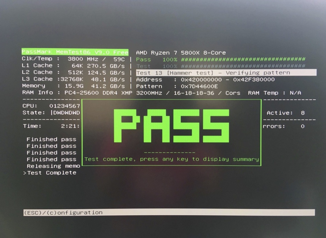

I ran the memory test (windows default one) again and it came out without any errors. It was Witcher 3 that caused the crash and looking online I wasn't alone. But those posts were years ago when they didn't have a decent GPU to support it. I'm not sure if anyone here plays WItcher 3. Witcher and Witcher 2 seem to be alright. Is Memtest86 better?
I ran the memory test again and it came out without any errors. It was Witcher 3 that caused the crash and looking online I wasn't alone. But those posts were years ago when they didn't have a decent GPU to support it. I'm not sure if anyone here plays WItcher 3. Witcher and Witcher 2 seem to be alright.
Did you run memtest86 or the windows memory test? You need to run memtest86, it's very different to the windows test.

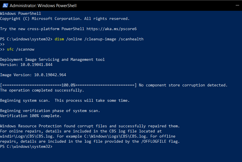

Now you know it's unlikely (though still not impossible) to be a RAM issue it's worth checking that there isn't an issue in Windows....
Open an elevated Command Prompt or PowerShell session (either will do) and enter the following commands one after the other and in this order. Allow the first command to complete before running the second....
dism /online /cleanup-image /scanhealth
sfc /scannow
Post a screenshot of the output after both have run to completion.
purplewakanda
sfc /scannow
