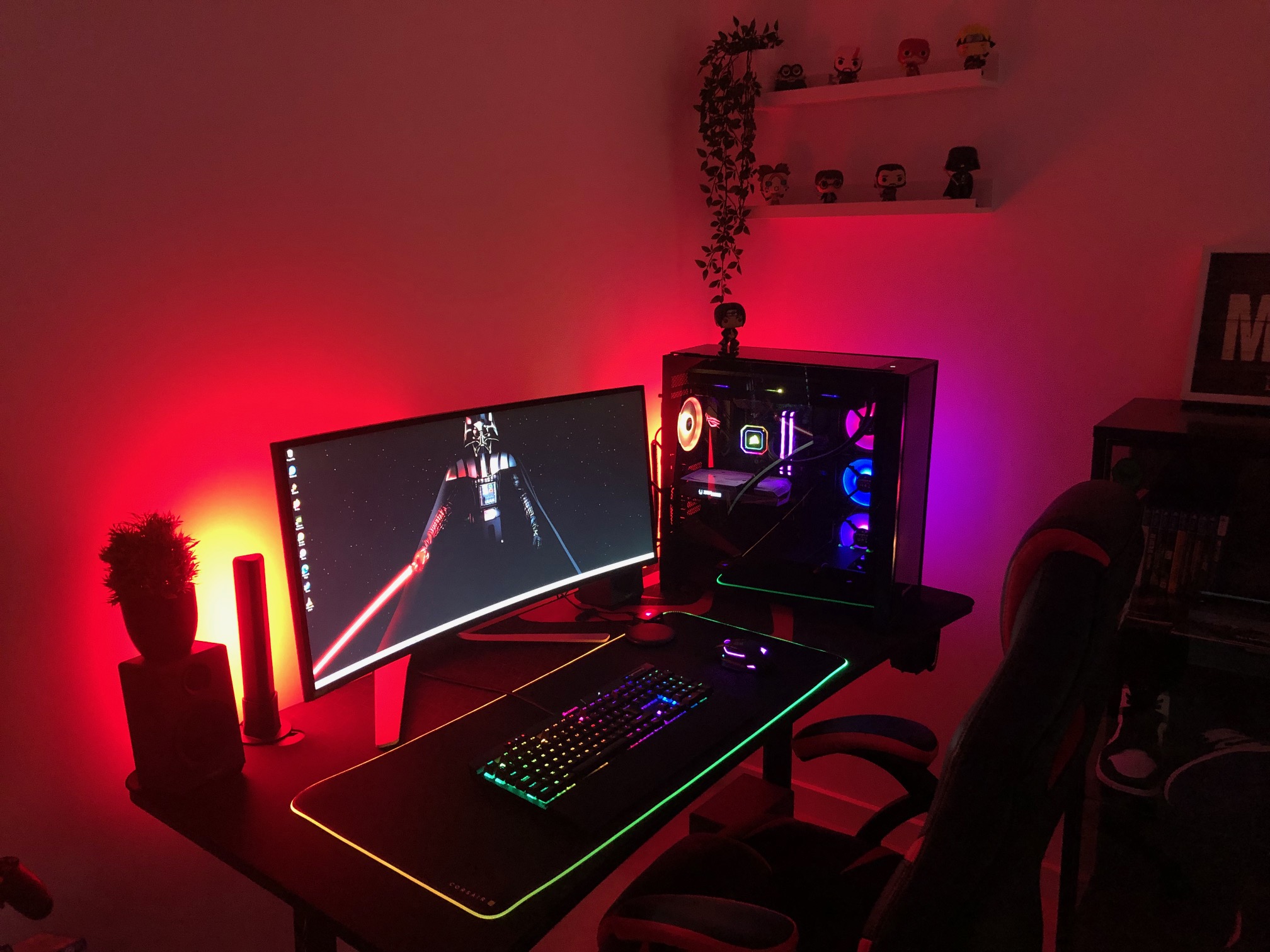

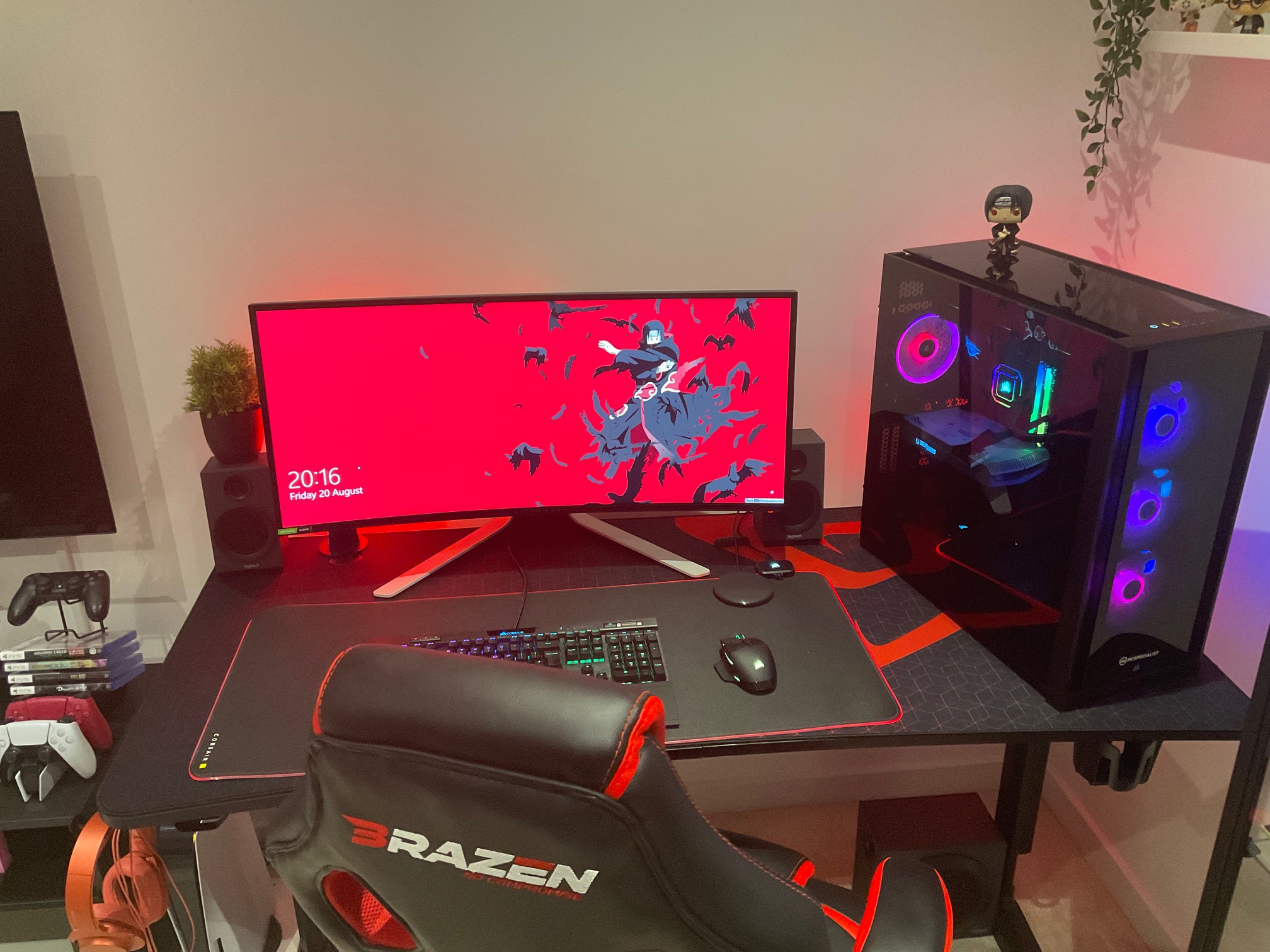

Hi guys, just as an update. I was able to get control of a few more fans (3 sides) after moving cables about. PCS have agreed to send a new hub across so I can swap the defective bit. All in all I'm happy with the customer service experience as they have been really helpful. They offered to have it sent back in but I said I'll try the fix first then decide after. To be honest I have sort of settled in with the PC (see attached pictures) and don't think I'm ready to part with it :p. Hopefully the RGB hub swap fixes it. I have attached some pictures and just want to say a Big thanks to everyone who helped!!!
