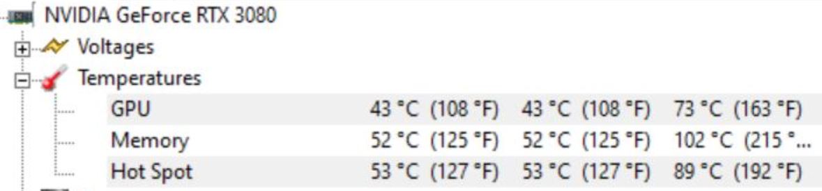

As a real world example, here's my temps after gaming from the other night:
The temperatures are (left to right) current temp, lowest temp and highest temp and were taken maybe 3 or 4 minutes after exiting the game. While gaming my GPU hit a high of 73c degrees which is fine with a thermal limit of around 89c as already stated in the thread. The GPU's memory hit a high of 102 which is 2 degrees above the upper limit of the target temp of 100c, but still below the thermal limit of 110c. I'll admit I was a little concerned, but after a discussion on here and reading around a little, I was reassured. As has been said in this thread, if you're going a little above your target temps, it may shorten the lifespan of the card a little, but I'll have my 5080 long before the card dies!
Sorry for the OT, just wanted to chime in with a little further insight into this and rather than keep it personal thought it may be of interest to the op and possibly others.
