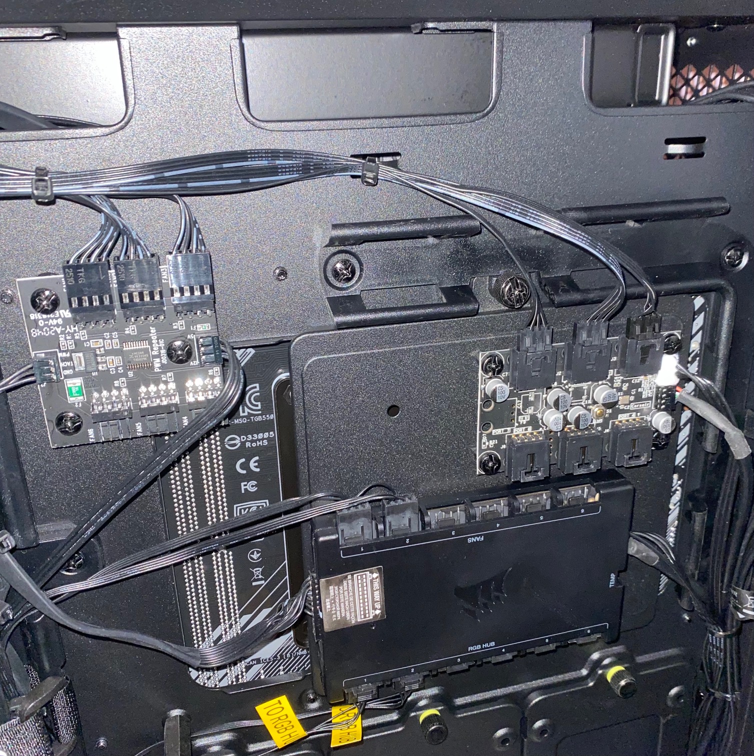

Could it be cause of not all of the fans being connected to the Commander Core? But that doesn't make much sense either because the radiator fans and the rear exhaust fans are connected to it but they don't follow custom profiles but the whole system only follows scenes lmaoIf the lights are all on, and the fans are spinning, its highly unlikely to be hardware...

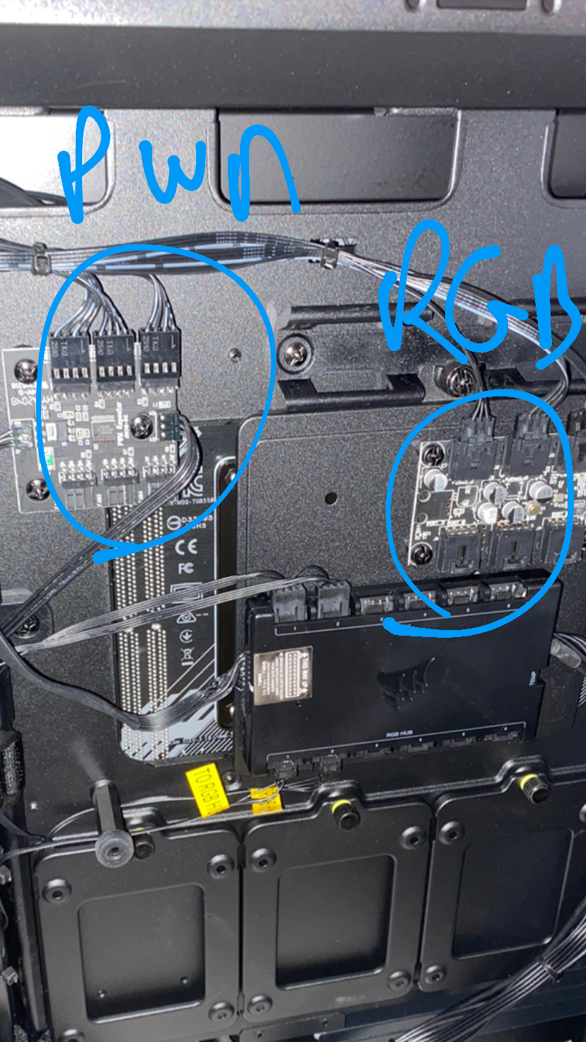

The front fans are connected to 2 different hubs: the PWM repeater hub and most likely another RGB hub with same design as the PWM repeating hubThats a little odd... I have a commander pro, so it might work differently, but my RGB hub is connected to the commander, which then connects to the motherboard. My cooler connects via USB to the commander, and its RGB is run through that, not the hub...
Have you traced what that second hub then connects into? Plus, it doesnt make sense to me how all the fans have lighting if iCue cant communicate with them.. when i had issues with mine it didnt display any lighting on the fans i was having problems with at all (until I rerouted).
I also connected the rear exhaust fan to the commander core, and yes the 2 you see are from cooler....I -might- have a solution....
The commander core, the two fans connected to teh RGB there, is that the ones from the cooler fans?
If so, i'd take them out, find the y split wire coming from the cooler pump head and plug them into that, then take wires from the repeater node and plug them into the commander core...
IIts a long shot, and based off how i fixed the lighting issues I was having here but your setup is different to mine
Yeah I can do that but I'm afraid to cut the zip ties and destroy a cable since they are quite tightThe cooler has its own connectors for its RGB leads, i'd plug them into that and then ditch the cheap RGB hub, swap all leads from it to the core. It is just a hunch, but I think it may work...its also just moving a few wires about, so easy to reverse if needed.
Nope I don't use those unfortunatelyDo you have a small pair of nail sissors?
Teeth it is then 💡Nope I don't use those unfortunately
