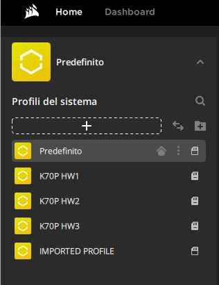

This is what I have

click the "imported profile" ... does it change?
I think we are doing the same thing just slightly differently (you dont need to create a default or use the three dots, see the little sideways arrows just above? thats what I used)
I think the way I did it automatically loads it, with yours, it adds it but leaves it on its current profile.

No it doesn't unfortunately when I click imported profile

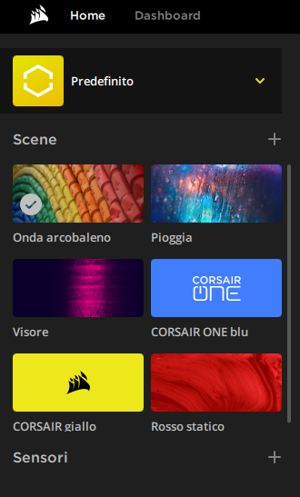

Oh... brainwave... kill the themes stuff!
Pic below... so on your homepage in iCue... the devices showing on the right, do you have little coloured circles in the bottom left of each box?
