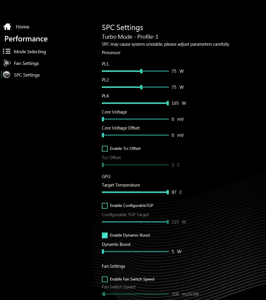

I've attached the SPC settings for al three modes, The office profile is different in that it has "Whispermode", initially this was set to "Quiet" but I changed it to "Balanced" to see how that would fare. Otherwise the only difference is the PL1 & 2. I didn't want to mess with them till I knew what they do.

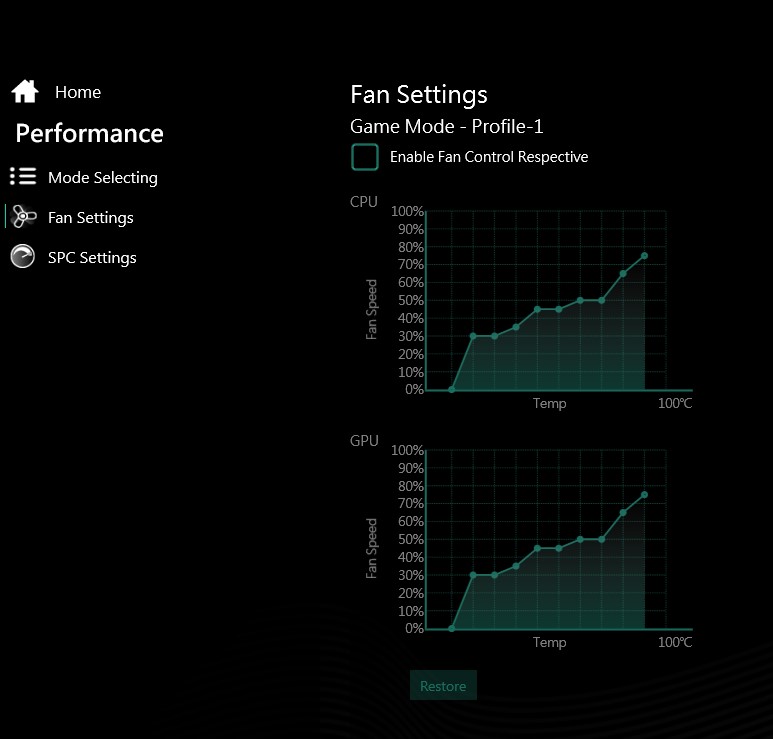

Interesting, seems to be similar to my experience. My previous was an Optimus from 2015, not sure what chassis that model would have been (are they always either Clevo or Tongfang?)
I attached the SPC settings in the previous post, game mode has PL1 & 2 at 60W..... if I understand correctly if I lowered these slightly this would lower the CPU draw? Basically if I can balance it so that the fans run at 50-60% speed that's a perfectly tolerable noise level. There is no scale on the fan settings graph but from what I can tell the fans turn on at 30% when it's 45^C, so if the graph is in increments of 5 then as soon as CPU goes over 75^C the fans go up to 65%, then 75%, and although I dont think it shows it on the graph I think they run at 90% when the CPU gets to 90^C

Good god those power limits are high!!! God bless Intel, no wonder your laptop sounds like it is taking off!
So your PL states are the power levels supplied to your CPU.
PL1 = Normal processor state. This is the power limit for the CPU during its normal state.
PL2 = Boost state or as Intel call it Turbo mode. Typically this is the maximum amount of power supplied to your CPU for up to 100s when the CPU is boosting, if there is the thermal headroom for it.
PL4 = This is a further micro boost which will happen for an incredibly short period of time, around 10ms.
Right, now that is out of the way you will notice that your PL1 and PL2 values are the same. This is quite normal, I am not entirely sure why hardware manufacturers set them to the same value. I believe it evens out the performance of the processer so that there isn't a large disparity between the base clock and the boost clock but I am not entirely sure.
So with my Valeon the default values are:
SPL (PL1): 55W
sPPT (PL2): 55W
fPPT (PL4): 90W
After a whole load of testing I have reduced them to:
SPL (PL1): 25W
sPPT (PL2): 25W
fPPT (PL4): 90W
Whilst this technically reduces the performance of the CPU, In practice the reduction in thermals far outweigh any loss in performance when gaming. The CPU temp has dropped around 10-15C and on average I only lose about 3FPS.
It is important to bear in mind that I have an AMD processor and they perform much better with lower power settings than Intel. So basically what I would suggest is gradually lower your settings and then run benchmarks, confirm the CPU is still stable and see what impact the reduction has had on performance vs the thermal efficiency gain.
Finally you should increase your dynamic boost value to the full 15W. Dynamic boost is a technology that allows your GPU to utilise extra power up to 15W to increase its performance, if there is sufficient thermal headroom in your cooling system. Reducing the heat your CPU is kicking into the cooler will give it that headroom.
Key points from me are to reduce your settings slowly and thoroughly test the laptop with gaming benchmarks before further decreasing.

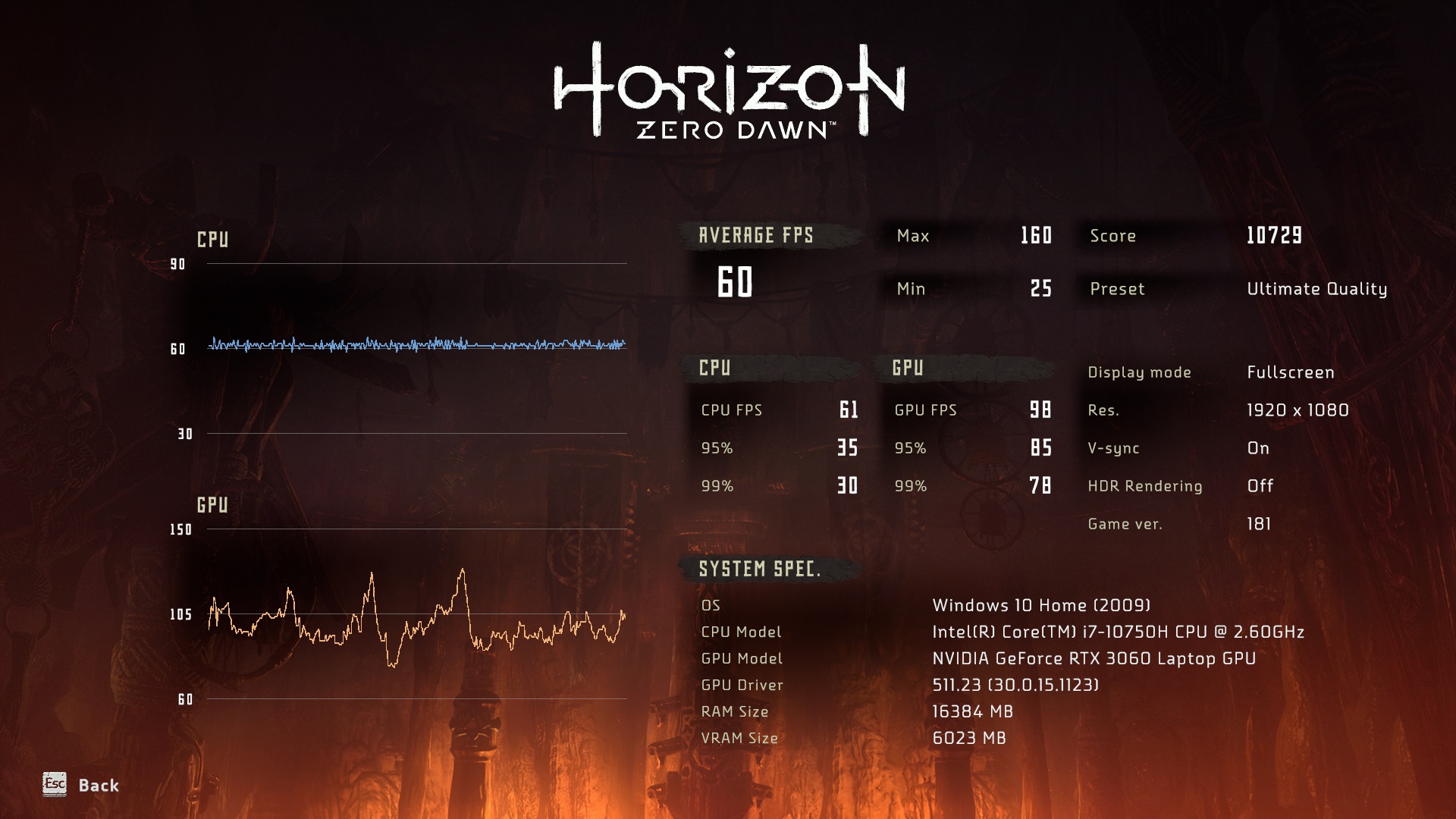

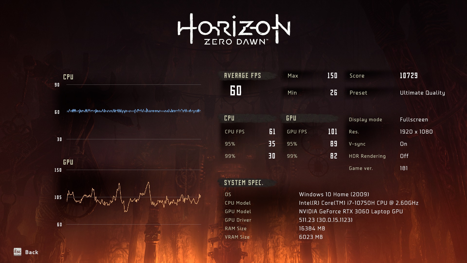

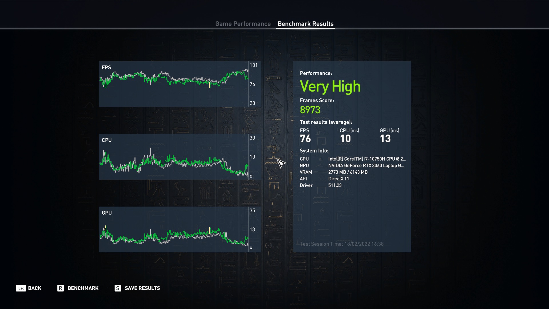

Attached are the scores for Horizon & Origins from the laptops default Game mode (60W), default Turbo (75W) & new Game mode profile at 40W.
That all looks good to me and if your temps are averaging between 75- 85C then that's a really good result.
I would imagine the reason Origins had a worse result when using Turbo would be due to aggressive thermal throttling.

Got my Game profile down to 25W now, Horizon benchmark score still seems unaffected, the AC:Origins score does seem to decrease geometrically with wattage below 50W but it's still averaging 68FPS at 25W so think i'll leave it at that and if the game has any problems while running i'll lower in-game settings a little. (in the benchmark it seemed to drop into the 50FPS range for a time, I think that's the yellow section on the graph)
At 25W it seems to top the CPU temp out around 77 or 78^C
I figure i'll make a separate profile for Turbo mode too & set it around 45-50W (instead of the 75W it is now) then if I get some more modern games that struggle I have a more powerful option just a button click away, but still should stop it reaching 90^C
Just out of interest, is it worth messing with the PL4 or should I just leave it given that it's such a short boost period?
Also, Office mode is still set at 35W, I figure i'll leave that as is even though it's now set higher than Game mode, but would there be any advantage/disadvantage to increasing or lowering PL1 & 2 for Office mode? Clearly there is more going on that affects CPU & GPU use between the modes than the PL states as Office benchmark for games is really low even with higher wattage.
Thanks for the advice. When I get a more recent game i'll post the benchmarks of those if anyone is interested.
So for my custom gaming profile I have brought the PL4 (for me its fPPT) down to 55W it seems to impact thermals but have very little impact on performance. Like you said it bursts to that level for such a small amount of time It probably only has an impact on serious productivity workloads.
