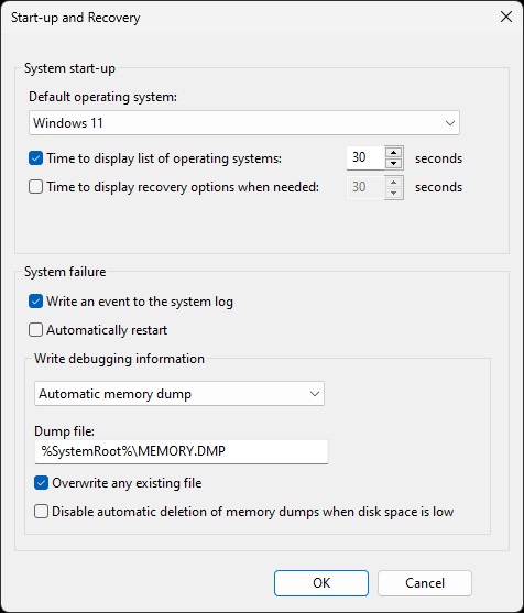

I suspect I know what your problem may be, but first we need to get you writing dump files, because without dumps we can't prove anything. Please ensure that ALL of the following are true...
  • The page file must be on the same drive as your operating system
  • Set page file to "system managed for all drives"
  • Set system crash/recovery options to "Automatic memory dump"
  • Windows Error Reporting (WER) system service should be set to MANUAL
  • User account control must be running

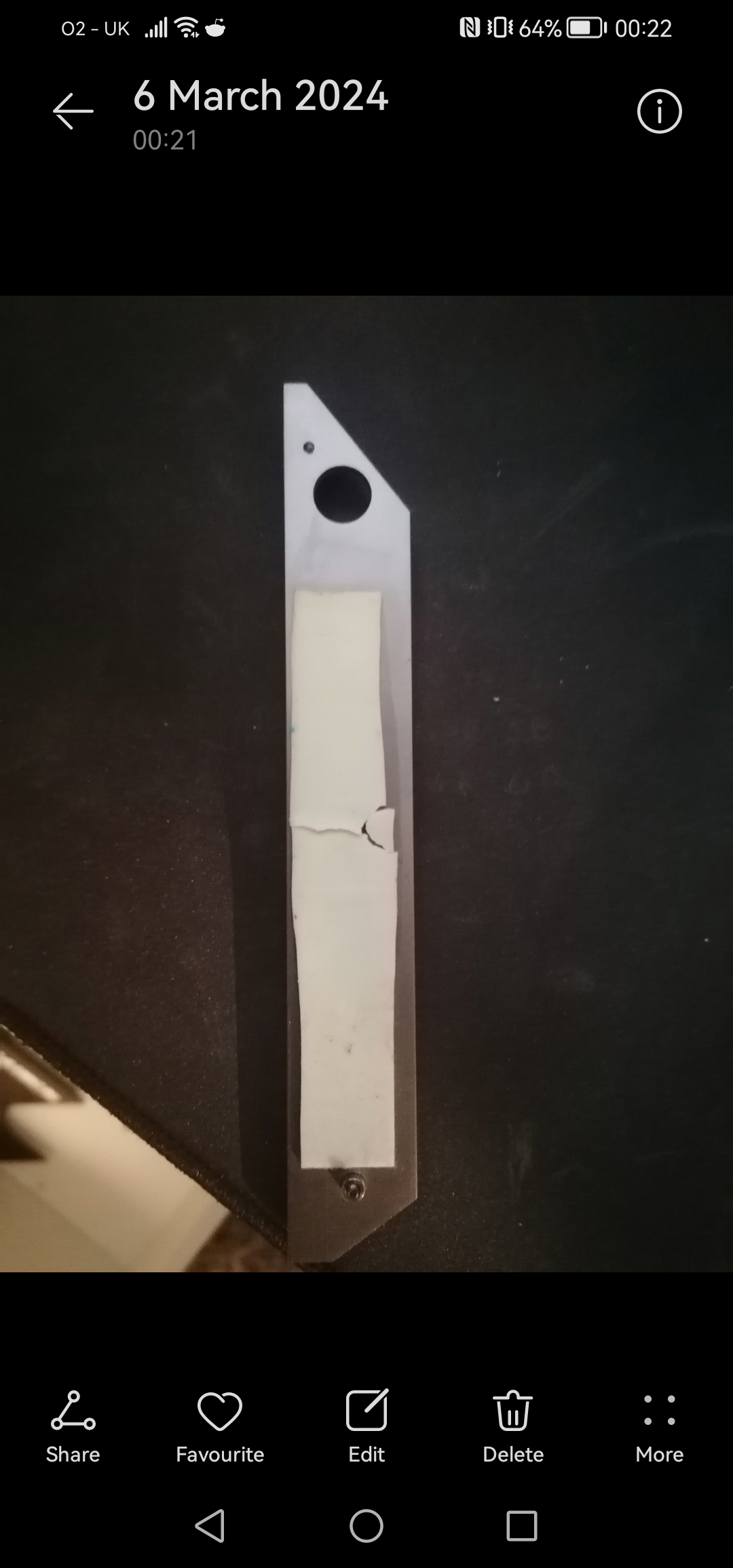

When I removed the nvme drive. I noticed the thermal pad was abit damaged. Is it still usable or would I need to install another. If I need another install. What would I need to look for. What size and thickness. Thanks
You'll need another thermal pad. Ask PCS whether they can supply one and if not what thickness to get.

I just been intouch with them. They are not sure if they can supply one and they not sure of thickness either.
I noticed they sell loads on amazon. Would any thickness do or would i need a certain thickness.
I have had a look and can't see. the bloke who i spoke to had a look at manual aswell. He stated to me he cant see it either.
If you measure the current one, just increase it by 0.5mm, that should be fine. I would have though 1mm would be ok.
I'd recommend thermal grizzly pads.
