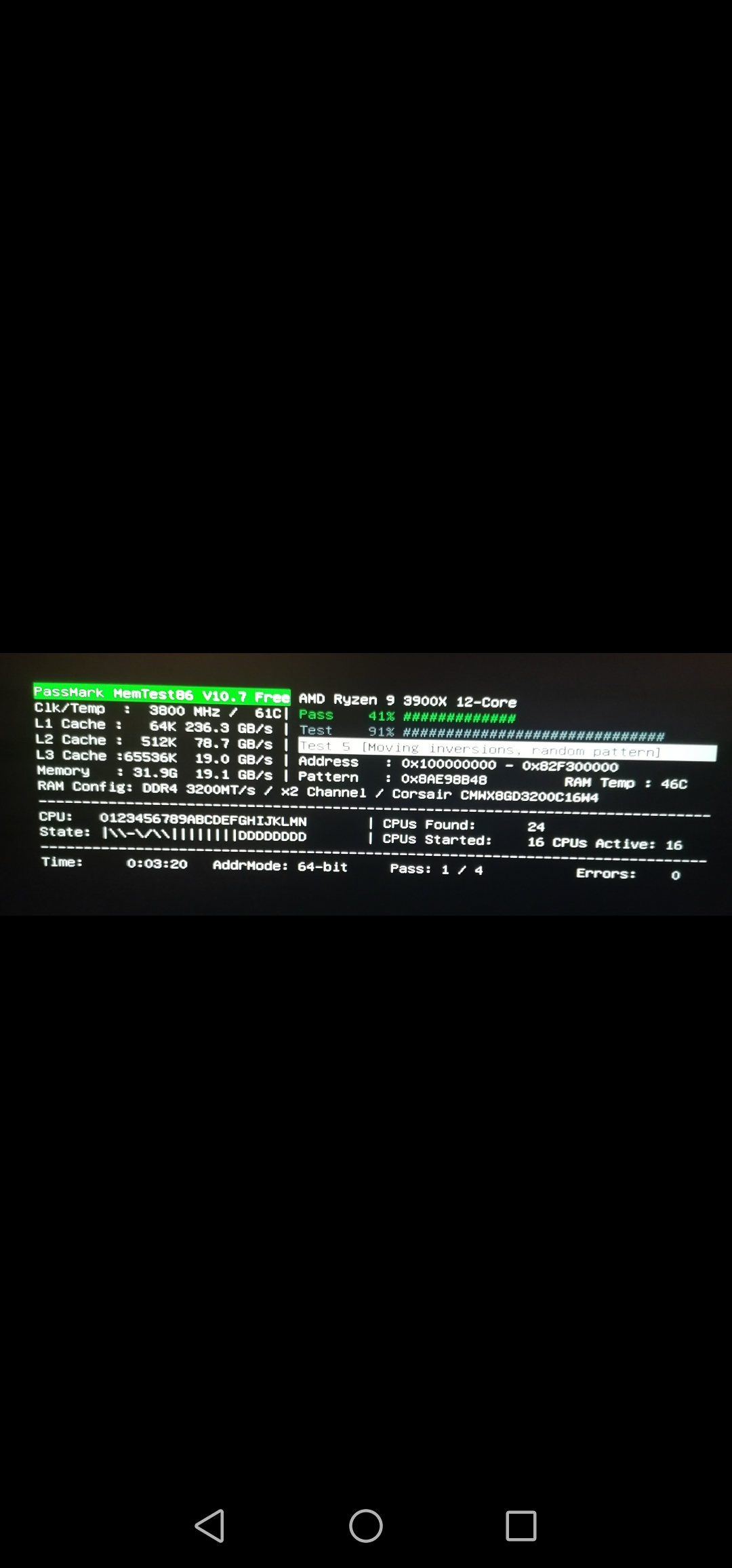

Could you please confirm if I am doing the memtest correctly thanks
carlos726811
If it was anything serious would I get bsod all time. Reason being. I can load game up. Within 10min I get bsod. PC powers off. I reload PC and load game up and can stay on for well over 6 hours. Then sometime It won't bother going off. I got told by pcs to do a clean install of windows again which I done.. I installed my wave 3 software. Loaded game up and crashed bsod. So now still running memtest
That looks fine, just let it run until its done all four iterations of the 13 different tests and then restart Memtest - so you end up doing 8 iterations.
