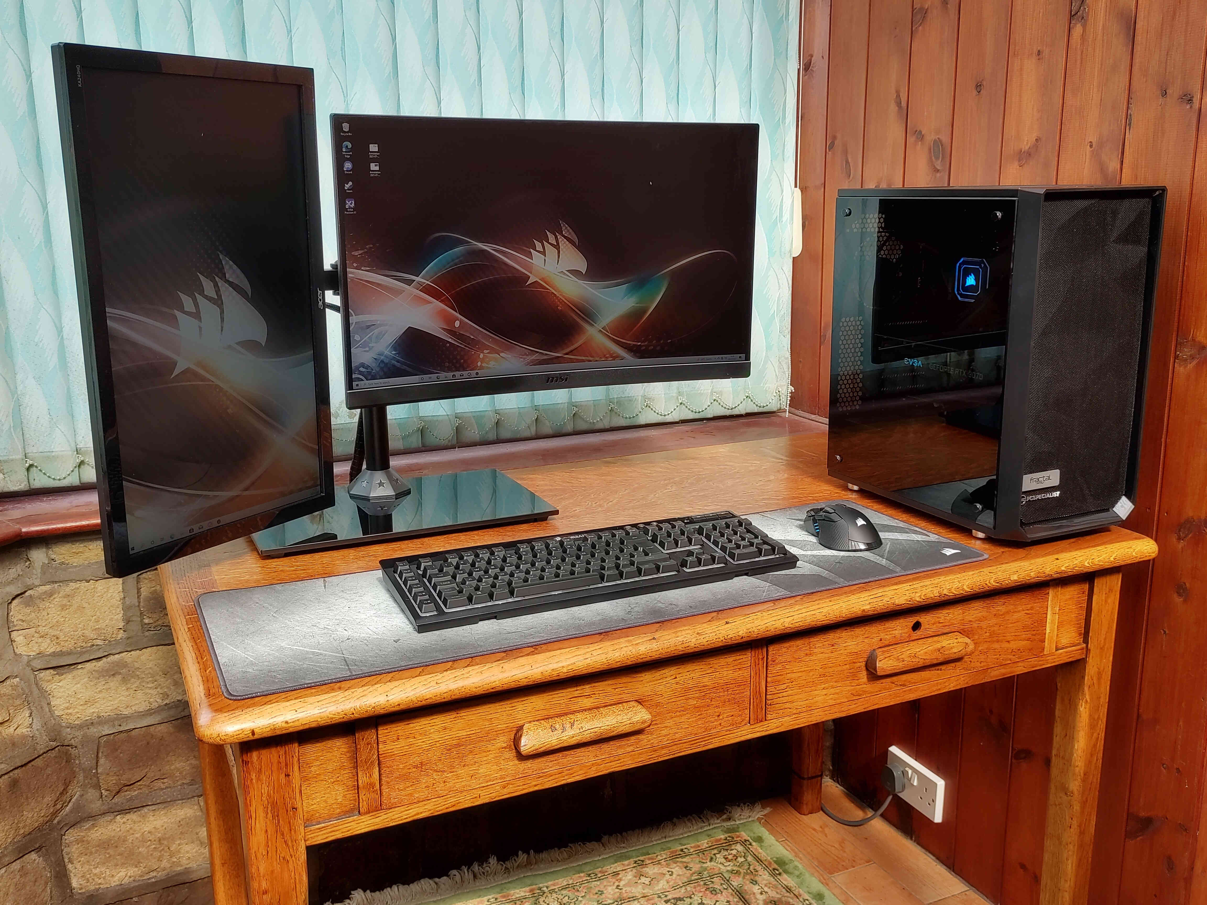

Finally up and running!

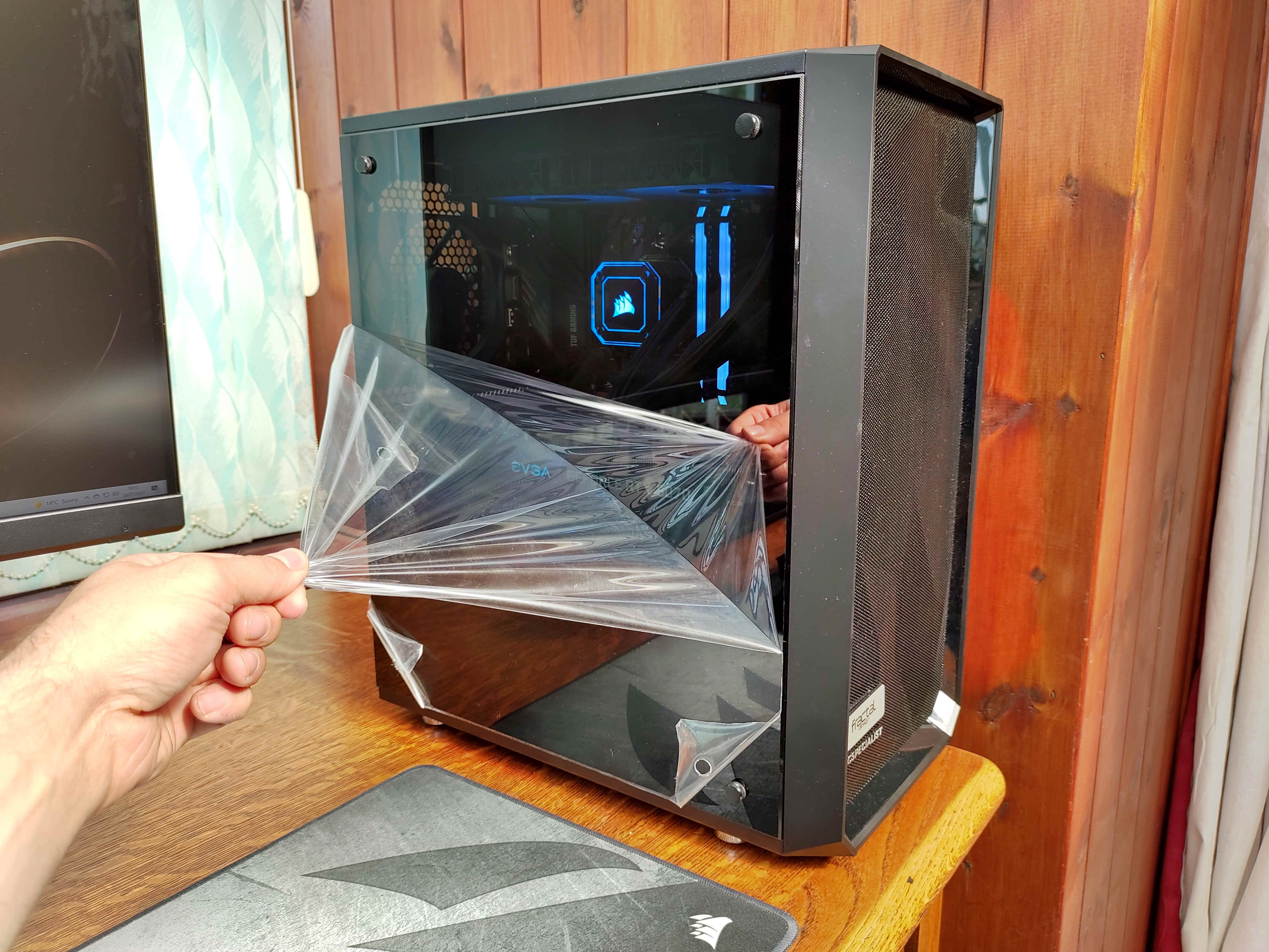

View attachment 28269View attachment 28270
That peeling shot… incredibly satisfying.

yeah can hear it just looking at it, nice looking system, love that desk as well
Thanks. I rescued the desk out of the skip at the mill I used to work at. It was the old weighbridge desk and is oak, I'm not sure who had the idea to throw it out. It needed a little TLC but it suits me just fine.
