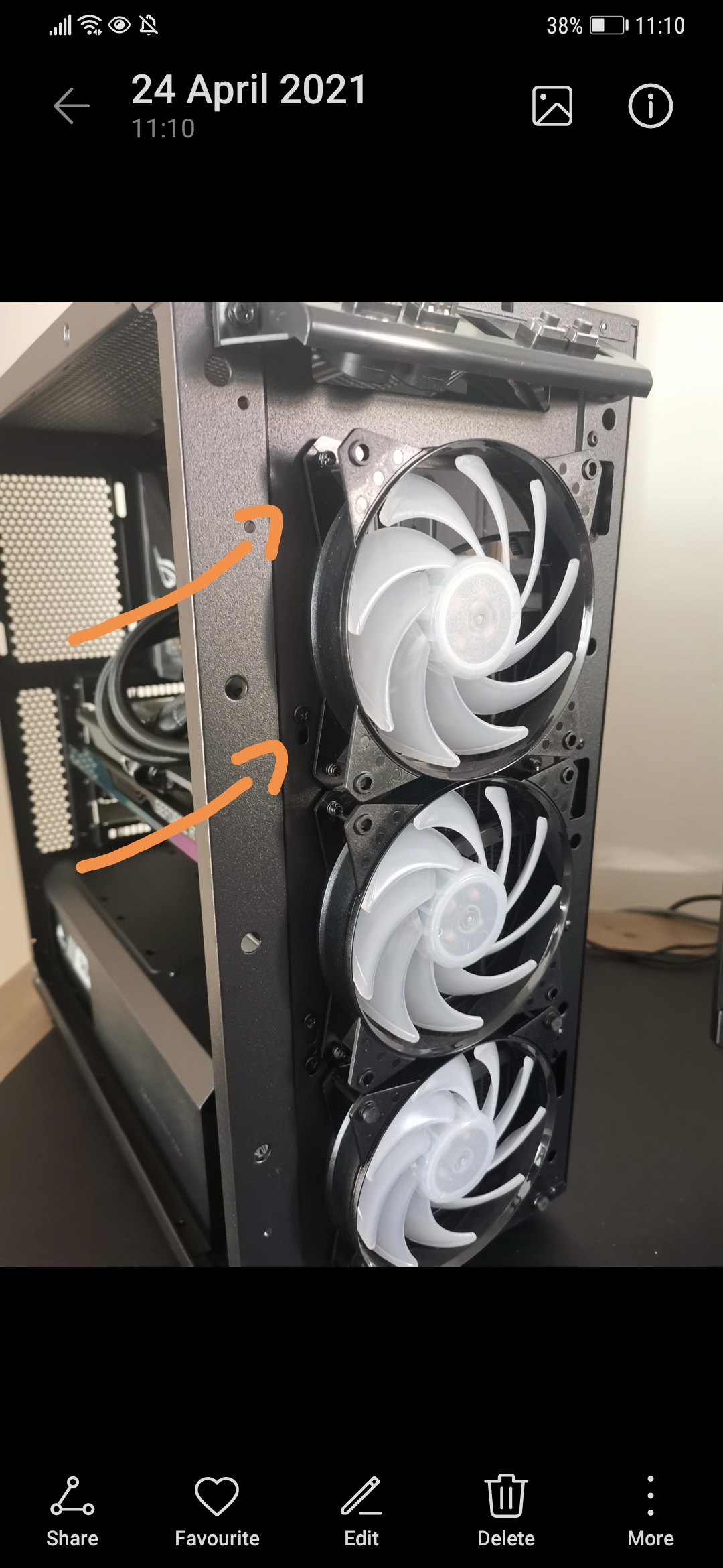

Hey guys, I've taken a look this morning. And I'm quite sure I cant move the radiator up (see below pic - missing a mount point where I've placed the top arrow). Ill be installing a rear exhaust tomorrow once the fan arrives. But I suppose my best option at this point would be to change to a 360mm cooler or change the case.... How dissapointing 😔
If you can get your hands on the tools you could make a hole? Pretty sure that would stuff any warranties though unfortunately

Yeah it had crossed my mind but probably not a good idea! Do you think there is anyway I could get assistance from PCS on this (e.g. Have the case changed)? Everywhere I look people seem to be of the opinion that my aio won't last very long/perform very well with this configuration

Not a bad shout - but still stuck with the issue of the pump being the highest part of the loop 😔 think I'll look at purchasing a new full tower ASAP and try to rebuild it..
Ask about swapping the H115 to a H100 or a H150 and doing the install yourself

Thanks, it's not so much the temps now, I had cod cold War running max settings earlier (Ray tracing etc to see how the system copes) 1440p at around 120fps at between 73 and 75 degrees. It's more than I know my aio is going to suffer because this 280mm system seems to be a really poor fit for the case. Best option seems to be to remove the 280mm aio and replace with a 240mm which I could top mount
