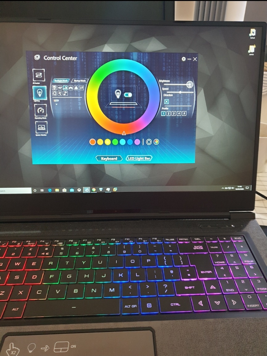

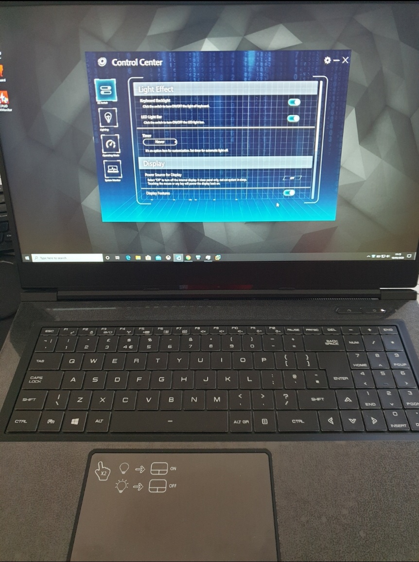

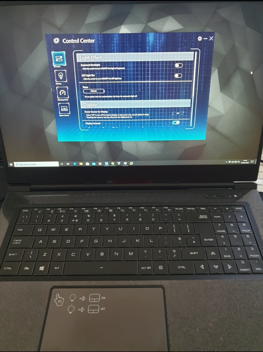

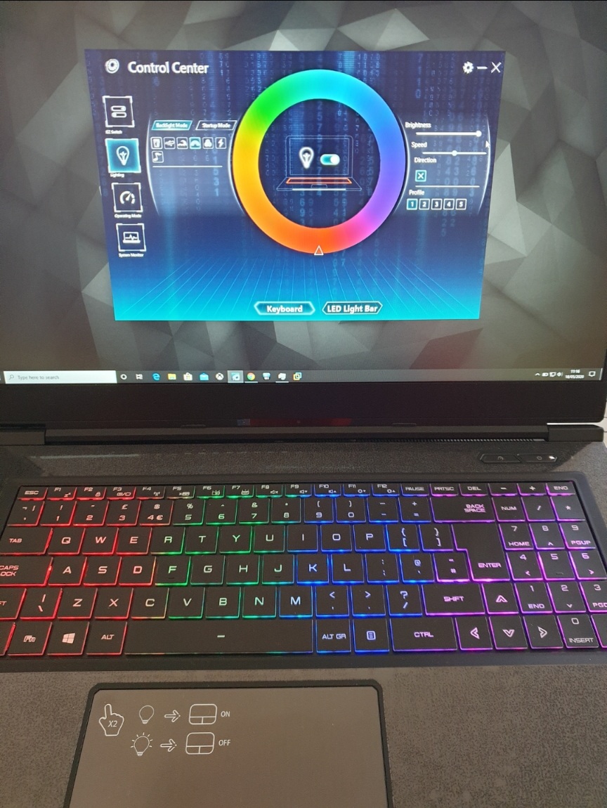

Hi Guys I just did the test for my keyboard backlight and lightbar below the touchpad.
I did on following order as pictures I will attach:
1. On Ez switch after turning on both keyboard backlight and LED Light Bar nothing happened.
2. After turning them on went to lighting, turned it on but still nothing because brightness on top right was at minimum, then after increasing brightness lights started to show up then switched to LED Light Bar on the bottom and followed the same procedure and as you see on images lights work great
Try and let me know guys, I hope this info will help you.
