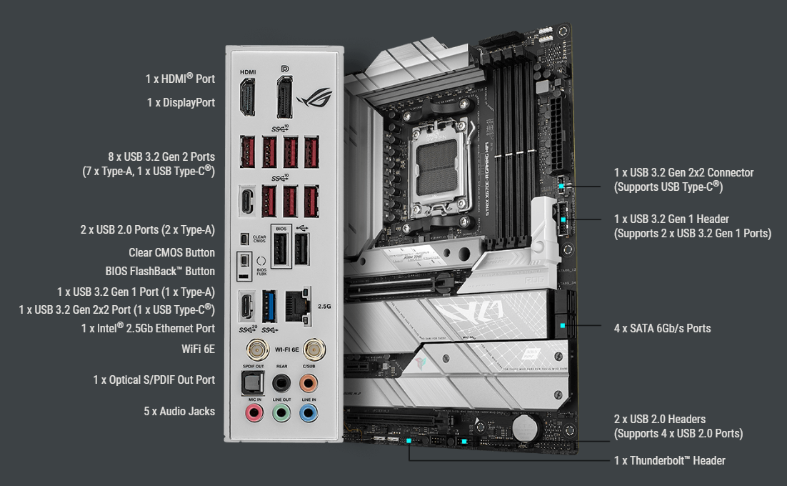

The motherboard is a really strong contender which will support future high end CPU's also. AMD have promised support through 2025 which likely means 2 more generations at least, but given their history, it will likely be 4 generations supported. The VRM's on this board are hugely overdesigned which means it will happily support future top tier chips.
This is the backplate of the motherboard.
On top of this, you'd also have 2 x USB 3 and 1 x USB C on the front of the case.
