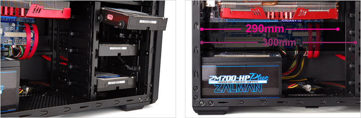

Here is the problem though case compatibility which sucks. Here is what my case can apparently fit
So it says 290mm cards but as you can see there is a bit of clearance and the whole thing is 300mm I'm probably going to get a ruler and check myself but still. So this card is measured wrong on powercooler site they say the cards dimensions are 266.65mm There is no way in hell it is that size I mean look at this thing

So I just took pictures anyway to give you an idea... the current length of the card in there is 261mm

Anyway it's a zalman z11 plus if you wondering about max gpu length that picture is from their website in other words they say 290mm but as you can see there is some clearance

It probably depends exactly what you measure, are you measuring from the I/O plate to the rear of the card, or just the body of the card.
If your case says it fits up to 290mm, you are trying to fit something in that looks to be 294mm, it might fit, but not worth the risk IMO. I mean you could go removing the HDD caddy and coming up with all sorts of (time consuming) mods for the chassis but might be a bit over the top.

Looking at pictures 4 and 5, even if the cage could be removed, the 3.5 inch drive bay cage thing would still be in the gpu's way. If your current card is 261mm and the new card is 294mm, it really doesn't look like its going to fit.
