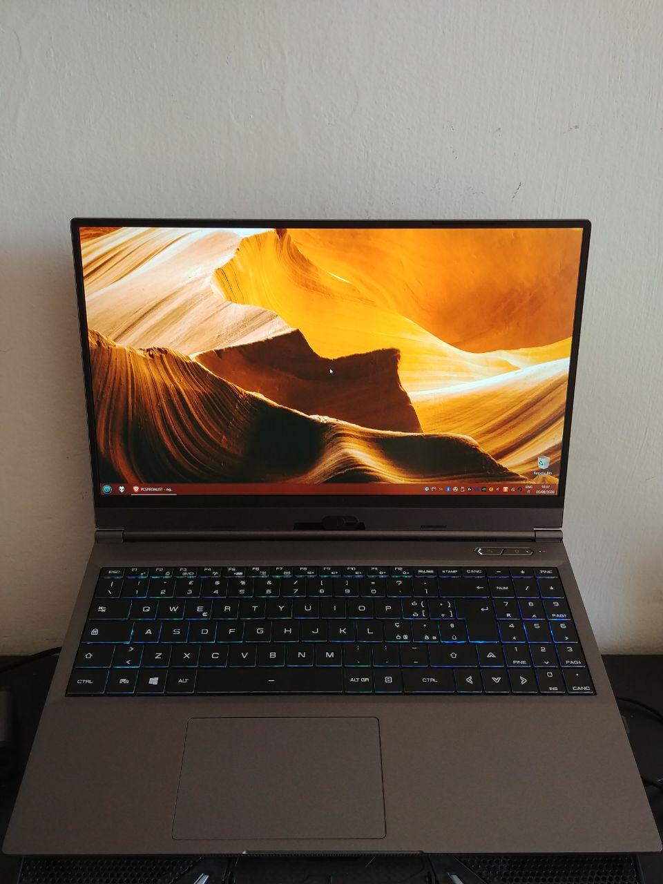

The screen: it is in 144hz, technology that I had never tried, it is another of those things that I can't do without without it, when I play with my 60hz (external) monitor it's not the same thing, it seems to play more slowly. The difference is also noticeable in the Windows system, moving windows, or watching videos. The brightness is really remarkable, I have not tried it outside the home, but now, in August, I never thought that I would have wanted more brightness.
The screen used on the Vyper III is capable of reproducing up to 72% of the color range, a significant number for a laptop, considering that many other screens reproduce 45% of the color range, in fact I have left out many other laptops before getting to this one Vyper III precisely for this.
The screen has a very thin frame, 2mm, which really makes the difference, there is no wasted space, it is truly a pleasure to watch.
10/10 screen there is nothing I would like more.

the keyboard is in Italian in my configuration, but I have reason to believe that it doesn't change much in other languages. It has all the keys in "big" size, the enter key is not halved, the numpad is complete, it is a pleasure to write and play with it. The only flaw, after less than a month of use, the letters D and S have started to fade, so I remove two points from the 8/10 vote.

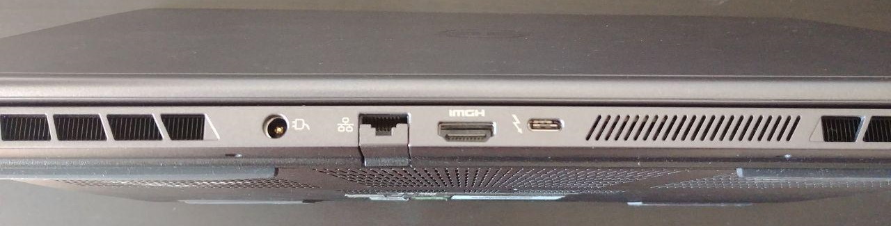

The inputs of the laptop are all what is expected, 3 "normal" USB ports; 1 usb-c thunderbolt port, which does not allow charging of the laptop, Ethernet, Hdmi, audio and microsd.

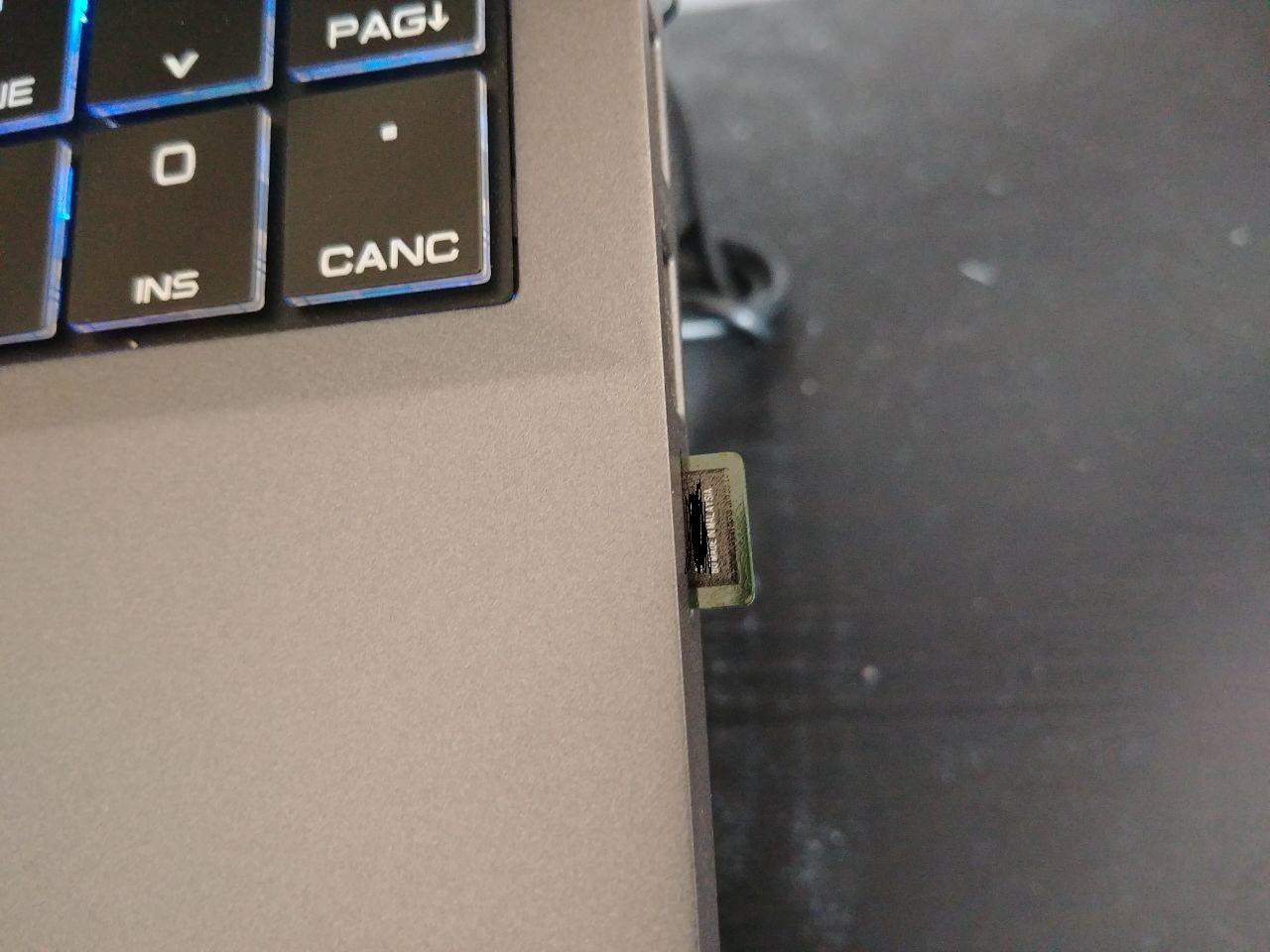

Personally I would have preferred that the microsd was totally inserted, in fact it remains outside for 2 millimeters, which seem to be few, but a right hit in the right place could destroy the inserted microsd.

Small inconsistency in the product images, in fact they show two displayport connections, which are not present in my laptop, also the Ethernet connection is behind instead of the side. I don't use them, but I found it strange not to have them.
