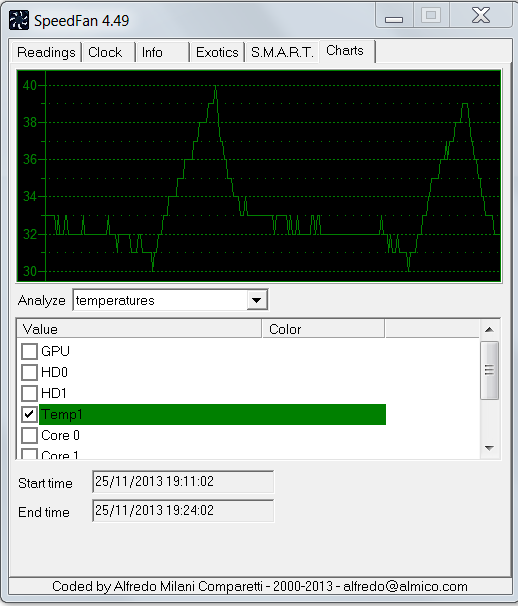

I am really liking my laptop however I have one major gripe - when browsing the web or doing anything non-intensive the fan kicks in arund every 5-10 minutes running very loudly for a few minutes before returning to being quite. I realise it is controlling the laptop temperature but is this normal? I certainly wouldn't want to take the laptop to a library or anywhere in public as its distractingly loud.
This is the temperature profile across 20 minutes or so via "speedfan"

Can you tell me the specific temperatures of the CPU and GPU and specs of the laptop? Is the laptop sitting on a hard surface leaving adequate room beneath it for cooling?

Thanks for the response. The laptop is the 17" Vortex IV review model (i7-4700MQ, 16GB RAM, GTX 780M, 120GB SSD, 750GB HDD (7200 rpm), w/ Blu-Ray player). It is only used on a solid, flat, wooden desk. Regarding the temperature readings this is what speedfan displays after 20 mins using google chrome:
Please let me know if it is other values needed or if these is a better program to get temperature values with.

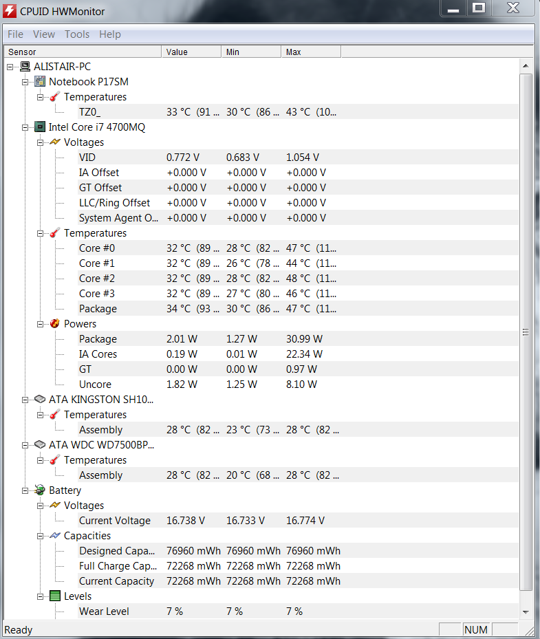

If you could download HWmonitor or speccy and show me the temps in that it would be a bit easier to read. From what that screenshot shows the temperatures don't seem to be a problem. Could be a temperature sensor playing up. How old is the laptop? If you can't get the problem sorted over the weekend then I would suggest giving PCS a call on Monday. They will sort it out.

Here is what HWMoniter gives:
The passive/active settings made no noticeable difference. I can learn to live with the fan noise, the usb issue is my primary concern at the moment
