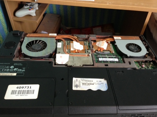

Ive had this (excellent) laptop since September 2011 but a few days ago it has started to shut down due to overheating, in particular it appeared to be the GPU according to my temp monitors. I cleaned out gunk from the vents and seemed to be back in business but now it seems to have gone properly and I've noticed the gpu fan no longer spins. Processor temps seem
I've got a silver warranty but with work demands I can't really afford to lose this laptop for even a day so I'm seeking advice on DIY fixes such as getting a replacement fan, applying arctic silver or upgrading the gfx card altogether if that's cost effective? It could potentially of course be a different problem altogether for all I know!
Is there anything I could do in short term to keep my laptop functional too? Like underclock or slow system down enough that the laptop will stop switching off even when idle?
Any help or advice would be much appreciated.

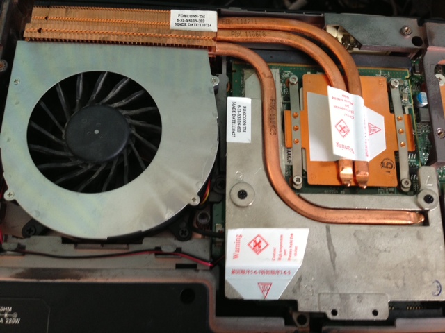

The fan on the left is the one no longer functioning.

I would give PCS a call, they might be able to send you out the compatable bits and pieces and maybe give you a talk through on how to perform the operation.
If that fan isn't spinning i wouldn't be using it as it doesn't take much for the GPU to get hot unless your using a cooling stand to keep the air moving a bit.
Can you not turn the GPU off until you've fixed the fan? At least you'll be able to continue using it for work if not gaming.

I've no idea, but I'm just off the phone with PCS there and they were very helpful. I've ordered a replacement fan which was quite cheap and hopefully it will arrive soon and solve the problem.

Just to confirm for anyone else interested. I promptly received the replacement fan and I also got some Arctic Silver 5 for the GPU as I only had stock thermal paste originally. Everything is going great now and I'm backing to around 40-44 degrees with normal usuage (watching videos, web etc).
