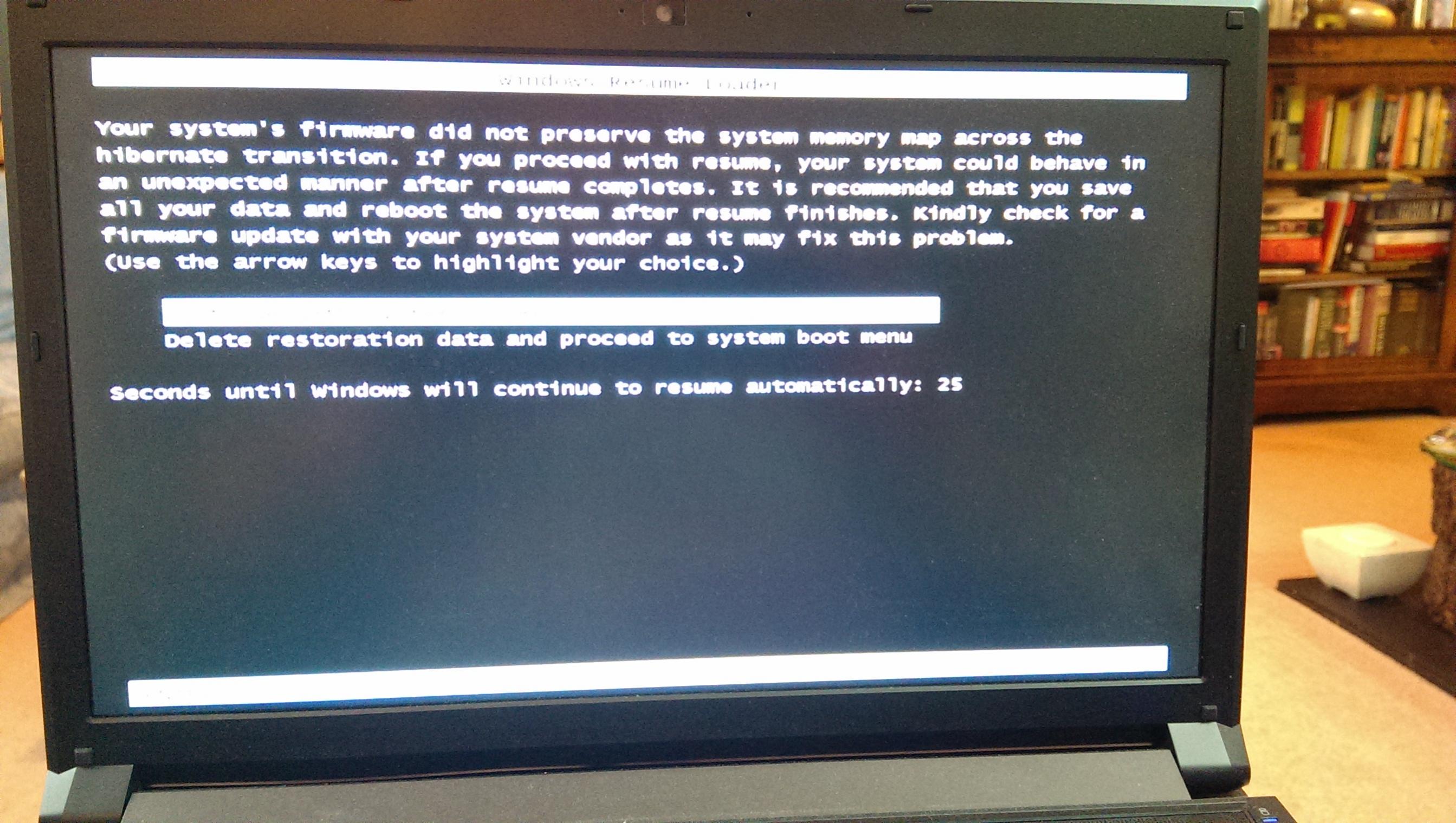

When I try to awake from hibernation I get a bios message saying
"Your system's firmware did not preserve the system memory map across the hibernation transition.... kindly check for a firmware update with your system vendor".... (see attached pic)...

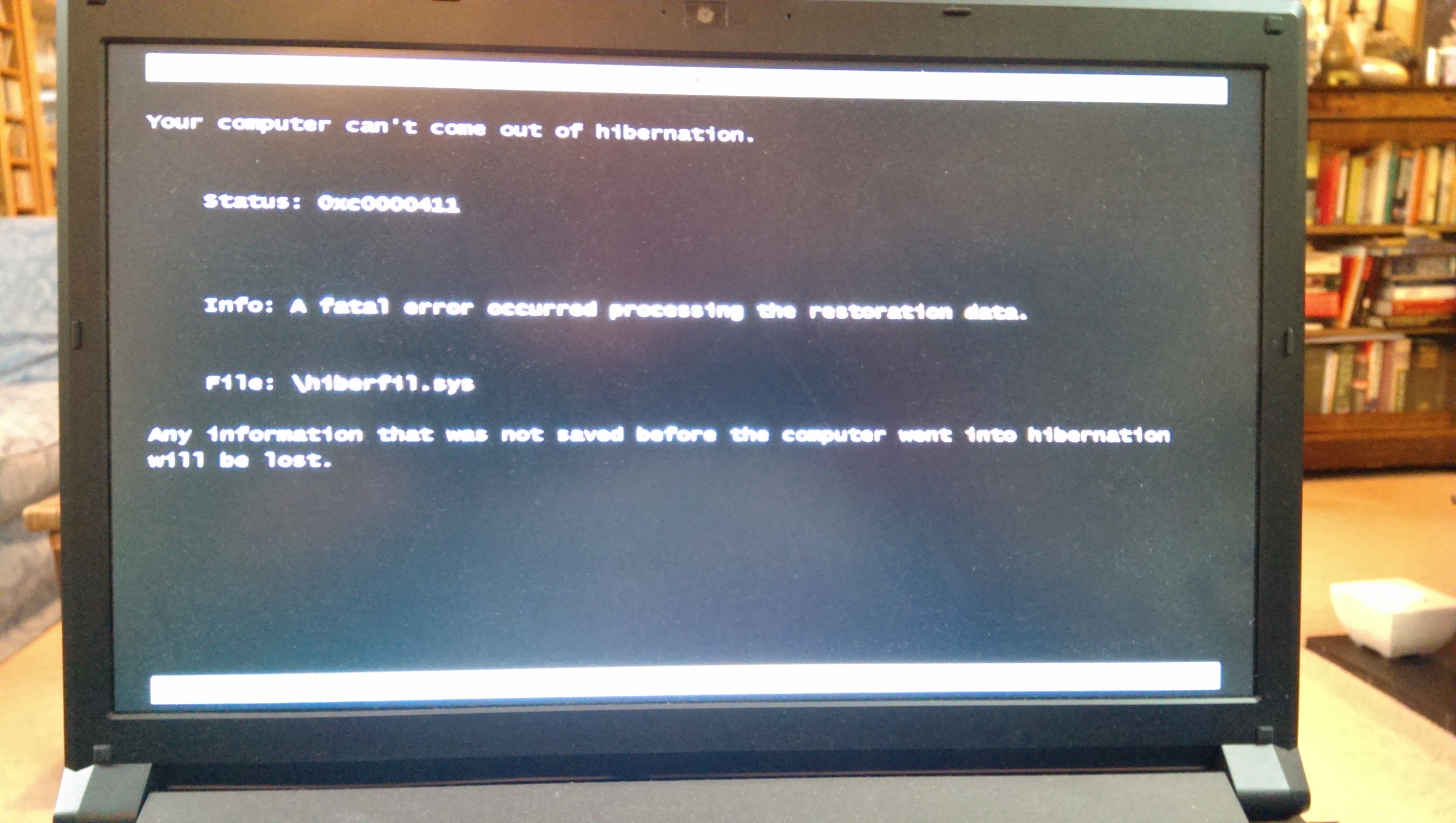

Then if I continue the resume I get another error:
"Your computer can't come out of hibernation status 0xc0000411
Info: A fatal error occured processing the restoration data File: \hiberfil.sys"
Anyone got any solutions to this ?

T
TheGeeza
Try typing this in cmd:
powercfg -h off
Then shut down the machine (Do not restart)
Turn it back on, open cmd again and type this:
powercfg -h on
Then test hibernation through window-shutdown-hibernate

marrob864
Did that previously. Tried it just now... it hibernated then awoke ok.... tried it again and it failed.... tried "powercfg.exe /hibernate on"... it hibernated and awoke once but again the second it failed... tried it again and it didn't even work once.
So it seems the first time hibernation is enabled it sometimes works for one time but then doesn't work thereafter...
So it seems I still don't have a solution.
