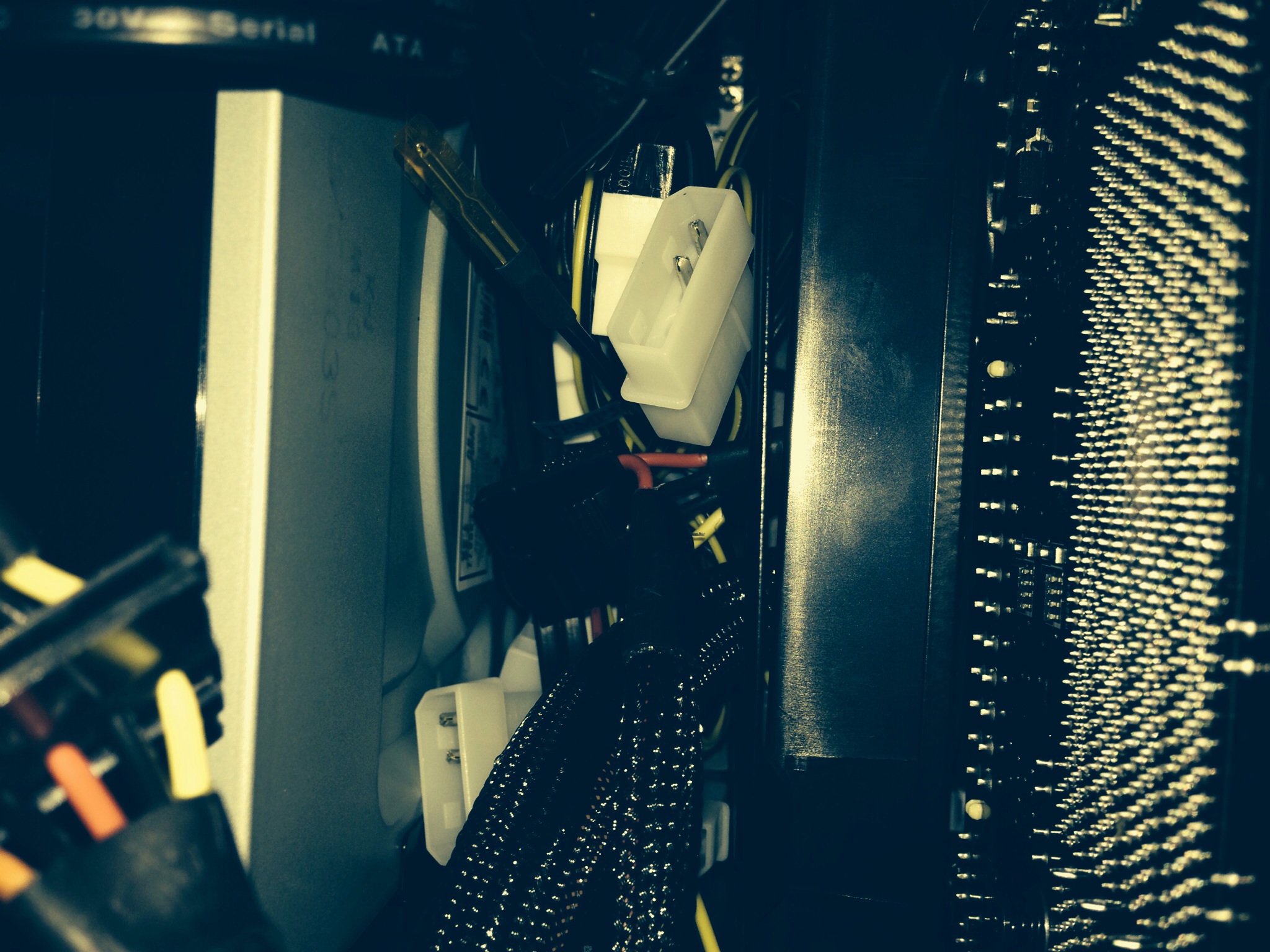

image.jpgI've just attempted to attach a picture from my phone.... Not sure if it worked...

I got an email back regarding the pictures I sent and they said attach the white plug to the power supply... How the hell is that tiny white plug going to reach the power supply... It's just ridiculous... I don't want to stores pulling on things either cause as soon as I put something else out of place there will be some made up crap about no warrenty for that... Having said that I got the premium warrenty option so this better be solved ASAP... I don't want to send anything back either cause then it's gonna be another 2 weeks to get my pc

Well, that is something at least, unless I misunderstand what you're meaning above - You have managed to trace the power cable back and show its plugged in and you can see at least one fan plugged into the controller.
Out of interest, do any of the case fans come on when you turn on the PC?
If you did manage to trace the power cable back, see if you can change the molex connector on the PSU to another one.
The PSU will have longer cables which can reach the white plug - rather than having to stretch the cable with the plug to the PSU - the white plug is most likely a molex connector.
The platinum warranty just extends the standard warranty to 4 years RTB (which means you send the stuff back to PCS and they cover the cost) if your fan controller is bust, you might need to send it back for RMA however if they are correct and you just need to plug it in then its not a big deal. Bare in mind the disconnection likely happened in transit which PCS had no real control over.
If you are not confident or comfortable doing it yourself, you will have to send the PC back to PCS for an RMA.

For anyone wanting to help solve... My case is the corsair carbide 540 air series...
kruppsy
Master
Which white plug are we looking at? the one with two metal pins visible? thats a molex, you should have spare molex connectors coming from the psu, just connect a 'female' to that 'male'? or is that one the one from the psu? confusing pic.
