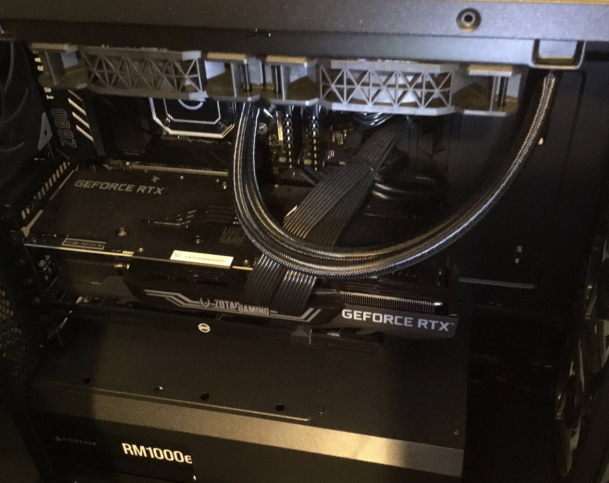

Hi, I hope this is the right place to ask these questions, I purchased a desktop for gaming last year (I will post specs below), I would like to upgrade the RAM from the 16GB it has to 32GB RAM. The problem is while I have always upgraded my own RAM in the past with this PC my cooler is top mounted and so it is blocking the RAM from being taken out or put in. When I took the side off the wiring is so neat and tightly wired that I don’t think I could remove the cooler without causing chaos in the wiring department and I wouldn’t even know which wires are the ones going to the cooler, so am I making this is more complicated than it needs to be, could I do this myself and if not, if I send it in for PC Specialist to add the RAM what do I need to do in terms of: Do I create a Guest account on Windows !1, do I have to share any passwords to my Microsoft account, or do they not need any of that? I’m wondering what the safest way in terms of security of my accounts is to send it in for an upgrade? What do others do? And from the photos I’m attaching and specs could anyone tell me how I can get around the cooler problem and fit the RAM myself? I really don’t want to have to hand over my precious PC to a delivery driver and spend the next few days not sleeping wounding if it reached its destination o.k (I’m a worrier lol), any advice will be greatly appreciated, many thanks in advance

The only wires going to the radiator should be for the fans and they are usually fairly forgiving and shouldn't be too tightly wound. You should be able to simply unscrew the radiator from the roof and just move it aside, slot the new RAM in then put the radiator back on without interfering with too much
To see what's going on inside you really need the remove the glass side panel, I just see reflections and glare in the photo so it's hard to see exactly what's going on in there

Many thanks, it’s def closely packed inside but if there’s lightly to be a bit of play in the wires I will give it a go, thanks again

The cooler is only held to the roof by 4 screws, one on each corner....if you have another person who can help, unscrew the screws then ask the person to hold the cooler where it is then lower it a little and tilt it towards you..there should be enough play in the cables to allow it to be titled an inch or two forwards
Many thanks, I have so,some with a spare pair of hands so I will give it a try, thanks again
Another option is front mount the rad, and put its fans in the roof, so the front fans push air into the case and the roof fans extract it

Yeah easiest option is to just detach the radiator temporarily, by unscrewing the screws at the top of the case (don't unscrew the fans off the radiator in other words). Probably 8 screws total, as it's a 240, so 4 per fan is the norm. Get your helper to hold the radiator while you remove the current modules and replace with the new ones, then screw the radiator back in. Prob best to keep case upright so you don't introduce bubbles to the pump.

Also, looks like you might have dust filter in place on the top of the case? If so, remove it, the fans under it are set to exhaust, so you don't need to worry about dust intake, the fans will blow dust out if anything and the dust filter just adds impedance to the exhausted air.

Thank you, hadn’t thought about bubbles so that’s a great tip and I will make sure I keep it upright 👍

Yep there’s a dust filter on top, it came that way so didn’t give it much thought but your absolutely right and I will be taking it off when it’s switched on 👍
