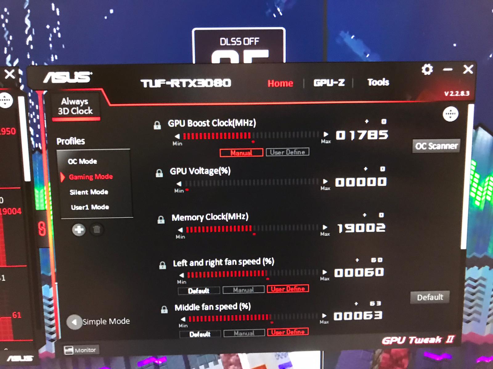

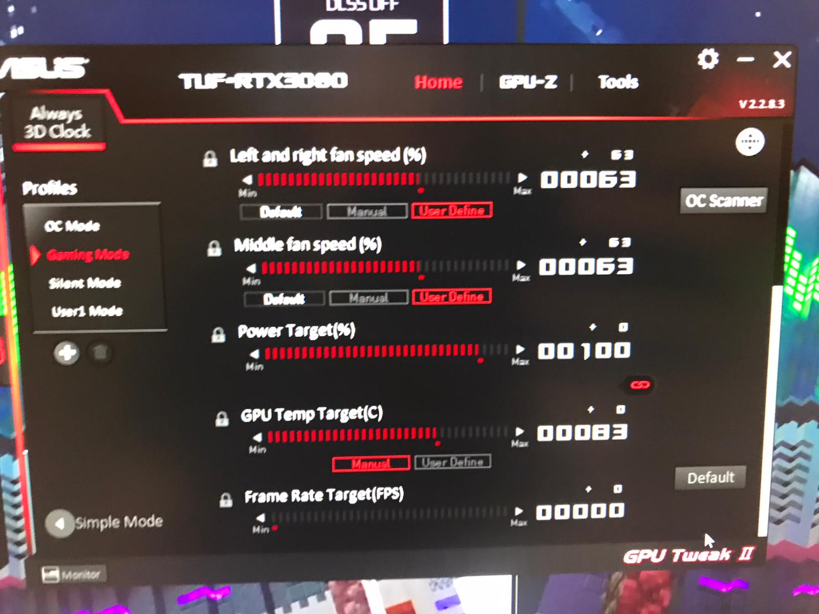

Are the attached any use or do you need me to install afterbuner/rivatuner?

I wonder if it's a sensor issue, display issue or just not enabled as, in the prior screenshot, the Frame Rate Target (FPS) is the same and displaying zero fps
What is the sensor a component of? Apologies for my ignorance, it's been years since I owned a PC, so I am learning again
