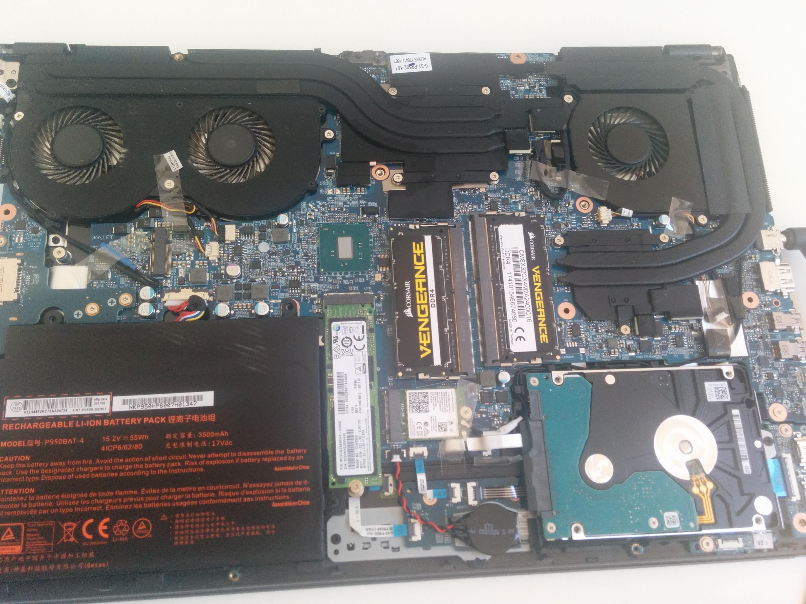

Ok, investigated more and it's definitely the fan on the down-left side.
Also the temperatures get high really quickly, I guess there might be a driver issue on Ubuntu 17.10.
Damn. How you guys manage this?

PS: my laptop still chirps, but hope I can fix that fan problem soon.
manioa
Hey Stephen, yes, Pop OS works great on it, but that fan chirping is really annoying. Hope I can find out what's the cause.

manioa
Hi Manioa. That fan chirping sounds like a hardware issue. Would be interesting to see if it still occurs with Windows 10 (although I never install Windows on my laptops). Not sure what the dealio is with PC Specialists in regards to ripping the back cover off a laptop that's still under warranty. The other thing to consider, of course (if it's still under warranty), is handing it to PC Specialist for repair. I certainly wouldn't continue using a laptop with malfunctioning cooling.
I didn't touch Windows since 2005, it is very unlikely to touch it now.
I am checking temps with sensors, they seem fine.
I also have a cooler master, but the left fan ( the one on the left of the touch pad runs continuously when my laptop is on and chirps).
[B said:
EDIT:[/B] Actually, does it occur if you start the laptop and go in to the BIOS?
yes
[B said:
EDIT2:[/B] Also, on my Defiance II, there's a key combination to turn the fans on full-power. I think it's something like CTRL + FN + 1 (I'm not in front of my Def2 at the moment, so cannot check). Would be interesting to see if the chirping persists if you turn the fans on full power.
Thank you for the tip, yes but less annoying. It also tends to do the second sound ( see the second vid )
When I press the combo again, it returns to the normal state and the chriping resumes after about 10 seconds.
It's definitely that fan.
manioa
All rigthy,
Problem solved.
I wrote to the support asking if there was a way I could solve it without sending my laptop back to Uk.
They told me I could open it and identify the problem then they would send me the component that was causing it.
Opened the laptop and ran it. That fan makes the chirping sound and it stops. The other fans are still rotating.
In the right side of the pic is that solo fan I am talking about.
Removing the bottom was a bit unintuitive.
But I found a very accurate guide: http://forum.notebookreview.com/threads/sager-np8950-clevo-p950hp6-review-by-htwingnut.805339/
Removed it, opened it, put a bit of grease and now it works.
All good, I can really enjoy my laptop now :)
