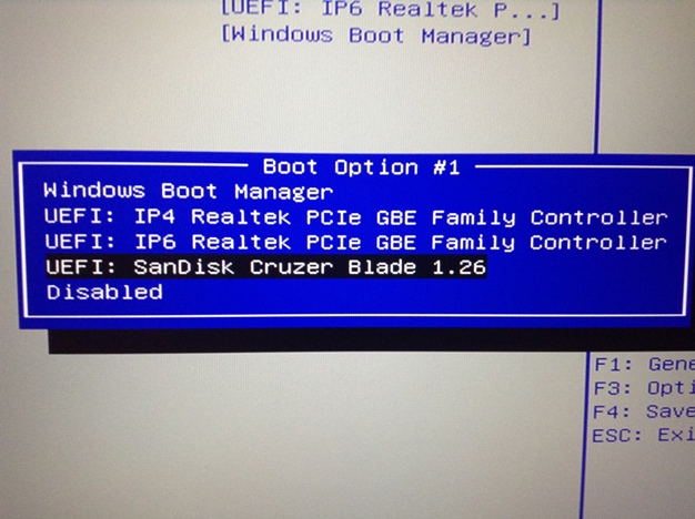

I have tried to get around the system booting this by moving the flash drive ahead of the windows system in the boot setup (as I should have probably done right at the start!), but the laptop still bypasses the USB drive and goes back to the error screen.

Secure boot is already disabled and I do not have the an option that reads "Boot list option". On the boot menu all I have is the list of boot order and a UEFI option within which UEFI can be disabled. I have already moved the USB to the top of this list.

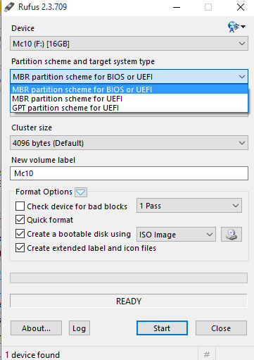

It's possible your USB is not formatted to support UEFI systems, since it works in legacy mode, but not with UEFI. The tool you used, dunno how it formats your drive. You can get rufus here: https://rufus.akeo.ie/

I meant in the BIOS
F8 is the windows boot menu, you want the BIOS boot menu which would be another shortcut.

Tried re-formatting the USB drive with Rufus as suggested in my previous post? Also, what laptop do you have? :)
Just tried it. No difference, it still bypasses it and goes through to the error message on the existing Windows test system.
