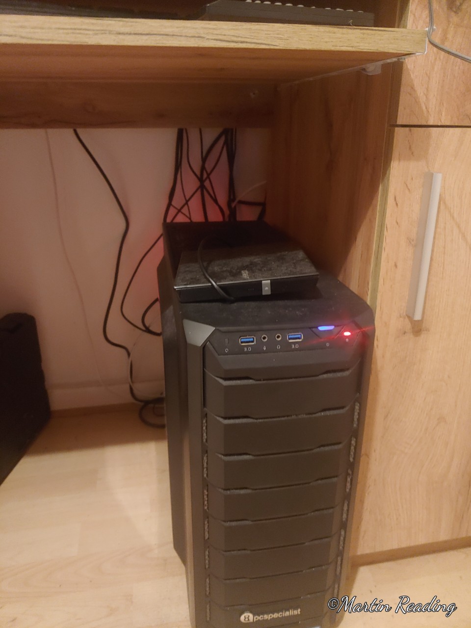

Once windows is all upto date, check that you've got the latest graphic drivers direct from Nvidia, then sort out backups & anti virus etc.
And of course i would download , install and get waterfox synced, so had got all my favourite websites to hand

My cable management at the moment is pretty bad, at least on par with what @Martinr36 posted, but I promise it'll be better with my new PC @AgentCooper!!
