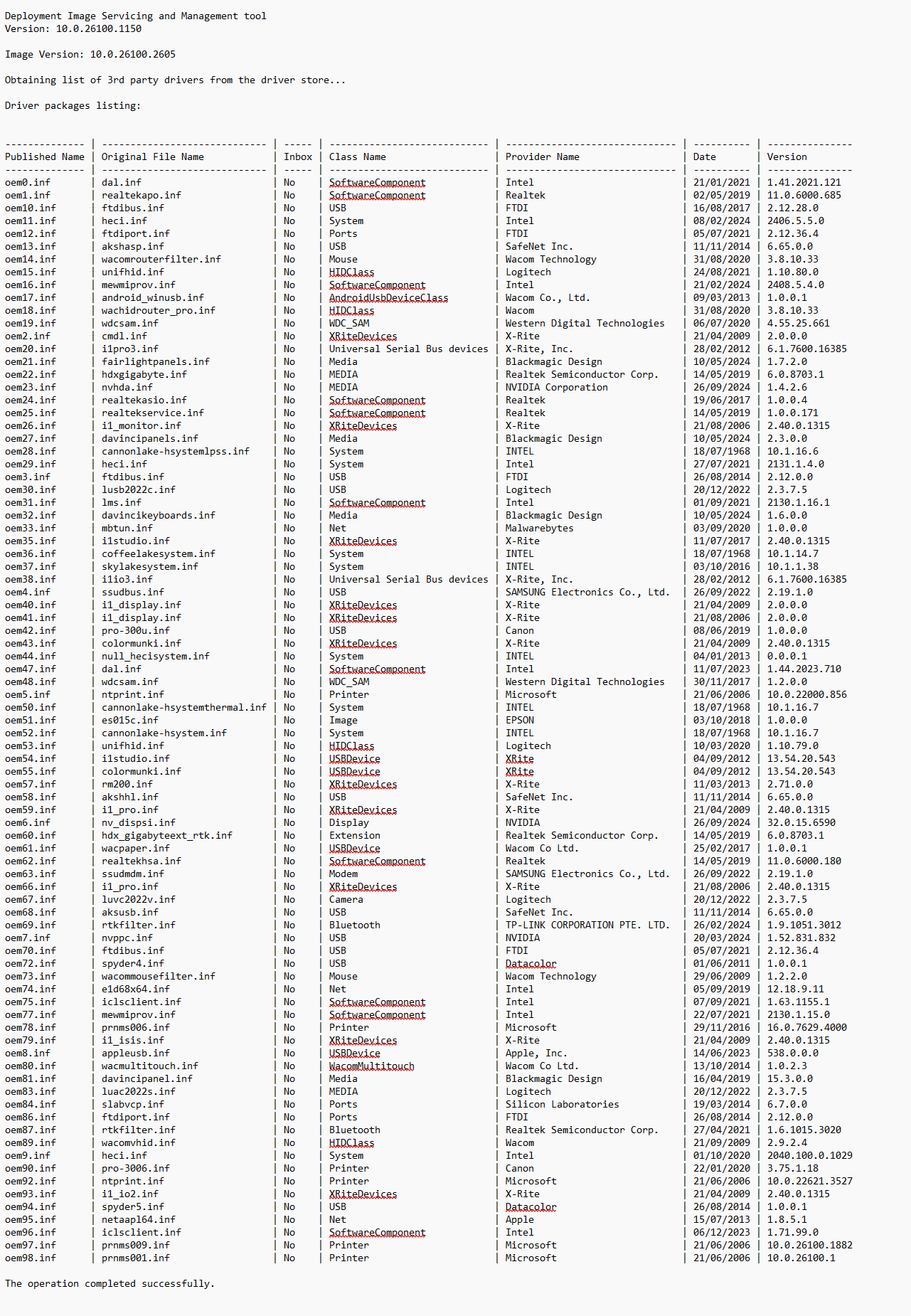

In your Temp folder on the system drive there will be a file called drivers.txt, upload that text file to here (or copy and paste it).

Drivers.text file attached as screen snip png, doesn't allow upload of txt files. I did try pasting the text in this message but it all ended up too many characters.

I'd have preferred the drivers to be uninstalled rather than deleted. The way to do that is to uninstall the product that delivered them.
I was going to suggest navigating to C:\Windiows\System32\Drivers and locating these drivers in there. Then rename them to change the ,sys suffix to .old. This will stop them being loaded, because they're no longer recognised as drivers, but will preserve them in case you really do need them. A reboot will ensure that these drivers are no longer loaded.
There are three other drivers in that list above related to the same product...
  • akshasp.sys
  • akshhl.sys
  • aksusb.sys
You should rename or uninstall these too. The fact that removing the other two caused an improvement suggests that removing these three might eliminate the problem altogether.
These drivers are associated with a company called SafeNet Inc but they have changed hands many times and are now owner by the French Thales Group. SafeNet Inc was a data security company producing authentication, encryption, and key management solutions. The list above shows those three drivers are being USB related, so I wonder whether the SafeNet Inc product you have is some sort of dongle authentication key? If that's enough information to help you discover what product you installed that included these SafeNet Inc drivers then I would now uninstall it.

  1. First open an elevated command prompt or PowerShell session.
  2. We now need the OEM number of each driver, this can be obtained from the list you posted in post #13...
    Code:
        akshasp.sys   oem13
        akshhl.sys    oem58
        aksusb.sys    oem68
  3. Enter the following command...
    Code:
    pnputil /delete-driver oem13.inf /uninstall /force
    ...to remove the akshasp.sys driver.
  4. Now repeat that command using oem58 and oem68, one at a time, to remove the other two drivers.
You then need to keep a very close eye on your system to detect whether or not these missing drivers are causing problems.
