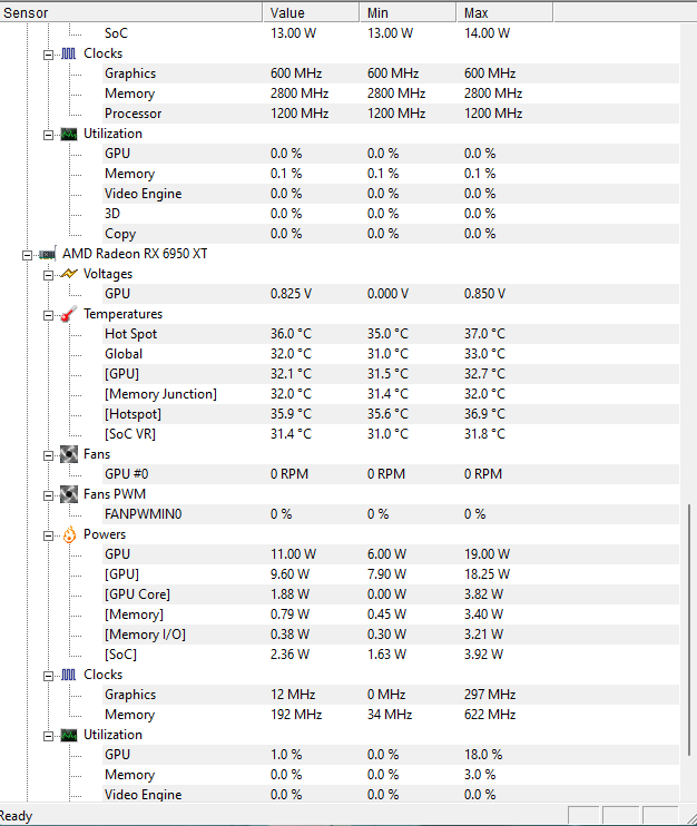

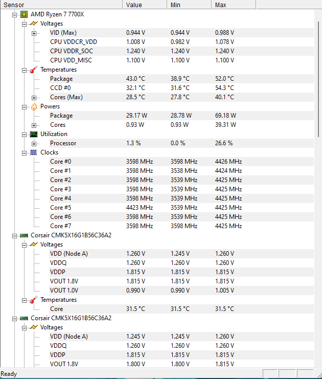

Problem happened three times again today while online. Twice without the pixels appearing, rebooting itself all three times. But the third time after rebooting the screen was blank and I had to turn the pc off and back on again myself. The problem hasn't happened while gaming so far.
Used HWMonitor while online with nothing else running. Screenshot attached.
Found these dmp files. Don't know if they'll help.
There’s no load during these readings that I can see, need to take screenshots while the game is running so we can see thermals under a game load, or you can apply a stress load with something like Prime95 for cpu and furmark for gpu.

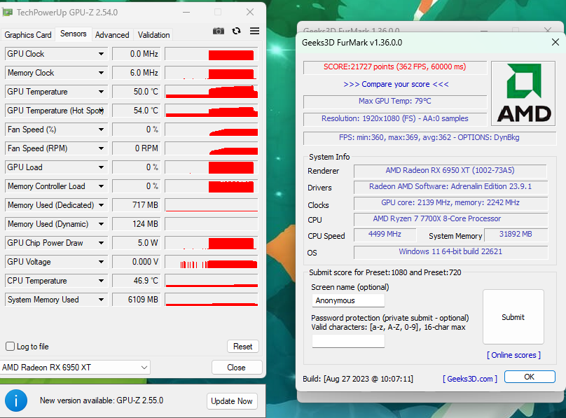

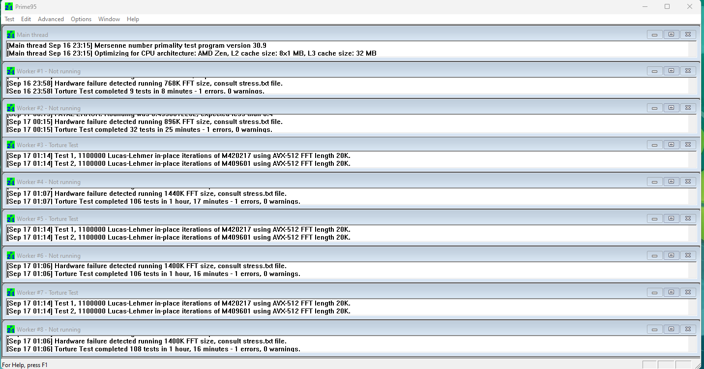

Tried running HWmonitor alongside prime95 and furmark, only for the problem to happen again with the pixels and pc resetting. When the pc rebooted an AMD bug report appeared saying there was a display driver issue and that it was now operating in safe mode.
The screen went black again (no pixels) with the fan going loudly. Turned pc off and on again only for the screen to still be black showing nothing. Reset pc again and the screen is working normally for now.
