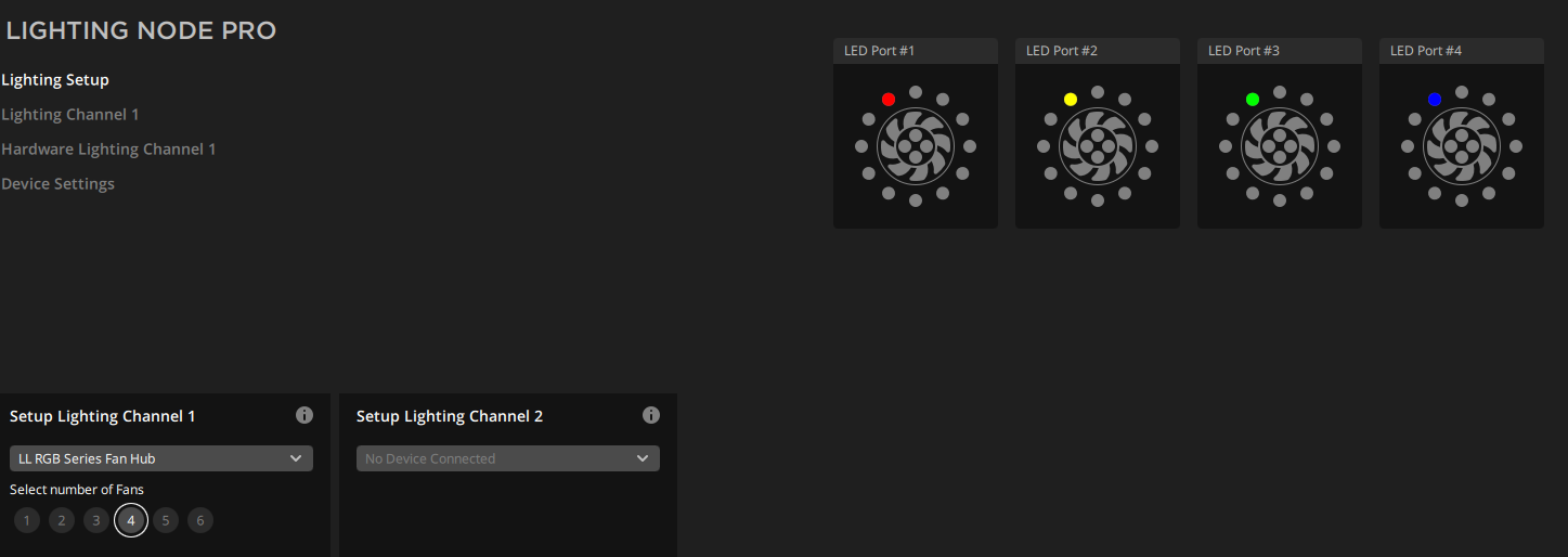

The rgb nodes looks like this -
JakAttack
Resident Metalhead
Staff member

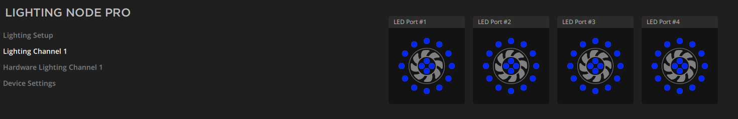

Are they lighting up now? I notice it says you are in Hardware Lighting Mode, come out of that if you can, this only affects the RGBs when not being controlled.

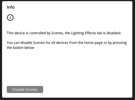

3080 is now under my control thanks :) I get this meassage when I go in to Lighting Channel 1 -
When I press diable it just goes but appears next time I open iCue
JakAttack
Resident Metalhead
Staff member
It may be worth giving us a call so we can check the settings remotely (you can ask to be passed to me (ask for 2nd line)). It sounds like one of the settings is out, it seems to be linking back to the Scenes/Hardware mode. Lines are open at 9AM on 0333 011 7000

Hi, I still seem to have to make adjustments to the cooler each day to keep it within the theme, I to have to disable scenes on a daily basis? Is there something I can do so that once I have set my lighting theme, the cooler doesn't go rogue on my next boot up and I don't have to touch iCue until I want to change it again?
I’m not familiar with scenes, but to set a profile you shouldn’t need to use that. Can you take a screenshot of where you’ve set the profile? Have you updated any firmware?
