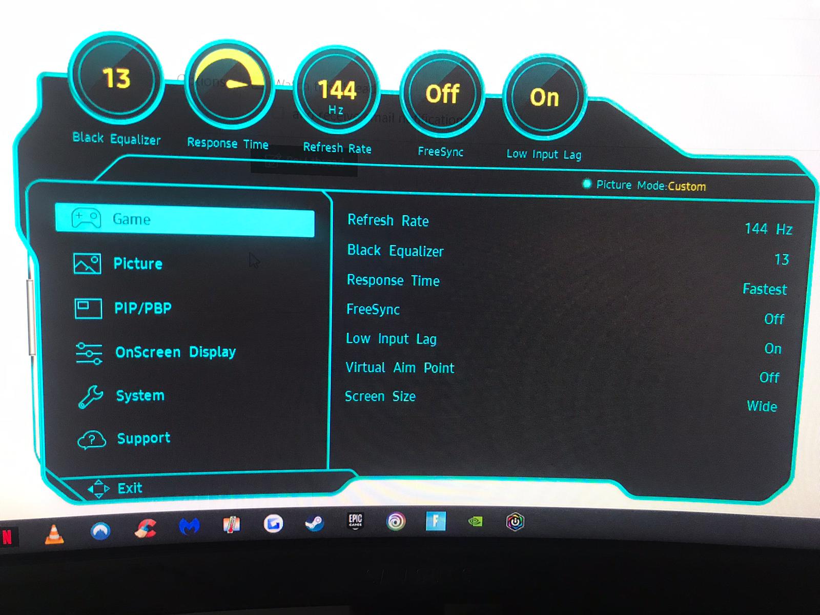

I recently bought the Samsung Odyssey G7, but I can't seem to set it any higher than 144Hz and it's obviously a 240Hz monitor.
I've had a Google and one of the replies to someone with the same issue was this:
Does that make sense to anyone because it doesn't to me.
If I go into the menu on my actual monitor, I can only adjust the refresh rate when I turn off FreeSync, but again, the max is 144Hz, which is what it's currently on.
I have installed all the drivers that came with the monitor.
I have also attached a picture of the monitor's open menu, which was only possible via using my phone, so I apologise for its potential lack of quality!
Can anyone help me out on this?

I notice that the connector is listed as "HDMI - HDTV"...do I take it you have it connected via a HDMI cable? If so, that is likely the reason as what I have read suggests HDMI 2.0 can only display 144Hz at 1440p (it can output 240Hz@1080p).
If you have a DisplayPort cable with your monitor (would be amazed if it didn't come with one) then try connecting with that as DP can carry higher levels so will display 1440p@240Hz

@Nursemorph you're a legend, that's fixed it straight away. So simple and I was tearing my hair out. I should have just asked here first of all!
