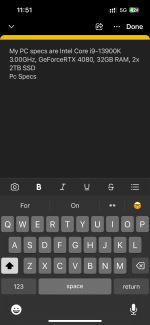

Hi. I’m looking to by my first ever desktop after 5-6 years of owning and getting frustrated by gaming laptops. Ideally I’ll be running and streaming Football Manager so I’ll need an I7 to I9 processor to run as many leagues as possible without it impacting performance and a decent graphics card to run it without lag/stutter
More importantly however I want it to be as quiet as possible with fan noise. I’m autistic and hypersensitive to noise and have been frustrated by the amount of fan noise coming from my gaming laptop (ASUS ROG strix). Any recommendations would be brilliant as I’m lost with the amount of customisable options available.
Attached are some specs that PCS sent me to buy as well as some specs a similar streamer uses which I would like similar too.
