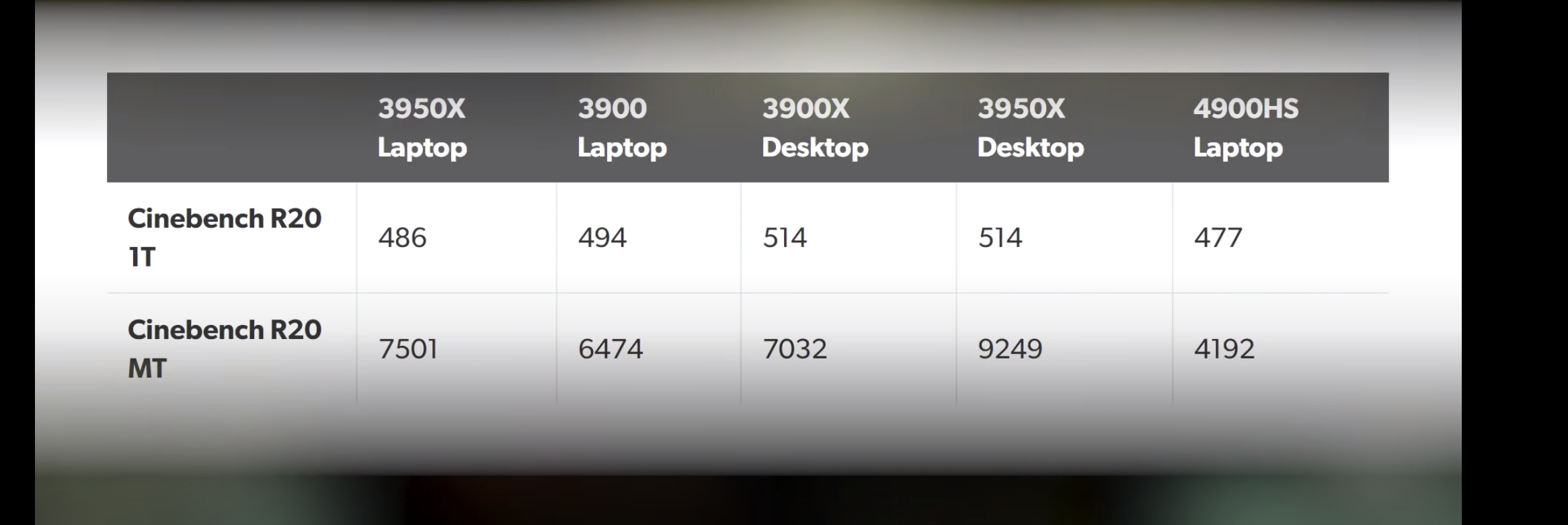

Hi, thank you very much for your response
this video comparison did find some benefit from the 3950x even at the lower power

That’s a different SI though so different BIOS and likely different cooling.
It’s also a very minor improvement for the increased cost of the CPU, just not worth it.

It is very likely possible to have a 3950x on this laptop, but I agree with @SpyderTracks that it is not worth it and you will lose your warranty.
It will run in eco-mode (65W) all the time, with lower clock speeds. So for gaming, the 3900 with 65W by default will perform better, some games will even perform better with the 3700x, because even though it has fewer cores, it does have higher all-core clocks. So the choice is totally up to your usage.

I had been waiting for a 3950x in a laptop and saw those. I also saw the reduced power and performance. They also only list 32 GB RAM.
