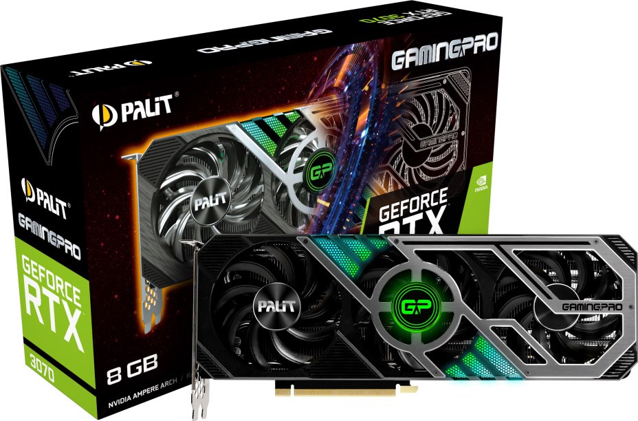

Hmmmm.... from a brief hunt on the various marketplaces, the 2080ti is selling for an absolutely rediculous £900 to £1300. Plus, you have to be careful in the second hand market as there are an awful lot of crypto second hand cards being sold, and they will have been hammered.
Brand new, you can get a 3070 which will just about equal the 2080ti in performance generally but have substantially better RTX and DLSS capabilities thrown in. And from a reputable shop, they're in stock now for around £800
But you may even find that PCS will sell you a card cheaper than you can get in the shops, if you go to the upgrades section of your main PCS account, have a look in there at what prices they're offering, you may be surprised. I believe the 3070 is currently out of stock though.
