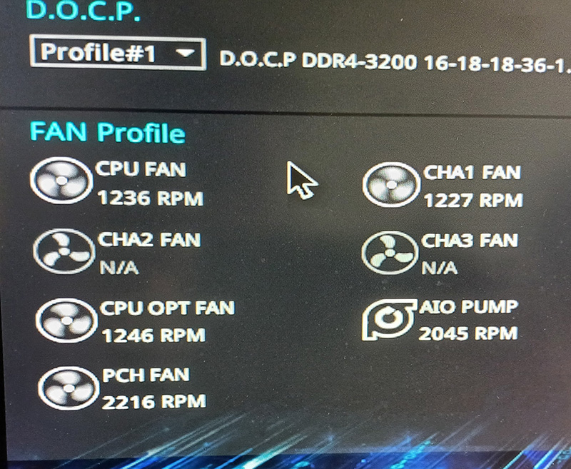

I have had the PCS FrostFlow 100 V2 Series High Performance CPU Cooler for about 3 years now but my PC has started shutting down when the temp goes about 105 degrees. I noticed that one of the pipes coming from the water block on the CPU is always warm to the touch. Is this my problem? I have clean the entire case of dust and it made no difference. Can anyone please help. I should also mention that my PC idles at about 70-80 degrees so as soon as I go to do anything on it it jumps above 100 degrees. Please help

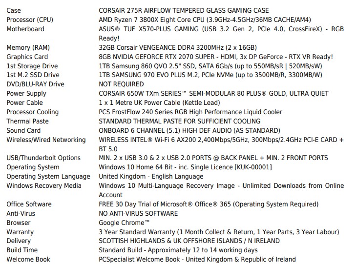

Can you post your full specs from the order page?

If only one tube is warm then this suggests that the pump has failed. We've actually seen a relatively high number of failures for this cooler one of the reasons we don't recommend it.
You need to contact PCS and explain to them that you're getting very high temperatures and that one of the tubes coming from the pump is really hot and the other cool. It's a pretty obvious tell that something is wrong with the pump and then take it from there
Personally I'd recommend a different cooler altogether

Just to be clear, I never claimed that the thermal paste was the cause of the issue; I agree that the cooler is probably gone here.
I posed this question since there was a discrepancy between the cooler mentioned in the post and the one listed in the specs.
I assumed it had been changed without the paste being re-applied correctly.
