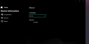

Hello guys, I installed newer version of Control Center to 3.9.18.0 (Older was 3.1.6.0) But I'm not sure the stability of the new CC version is good with my current BIOS version. I've had to uninstall 3.9 and to go back to 3.1 but 3 or 4 minutes after reboot Windows, PCS Control Center's version is changing to 3.9 from 3.1 on the background. I think there is still some files remained in CC's so it is triggering to change automaticly and UI is changing to 3.9 aswell. Is there any clean uninstall for Control Center to go back to square one? In practic I don't see any harm to use 3.9 but due to older BIOS version, I don't have fully control of CC (for example undervolting the CPU, only new BIOS owners can do that with the new CC version). There is no point to use 3.9 as long as it is not allow me to use fully control.

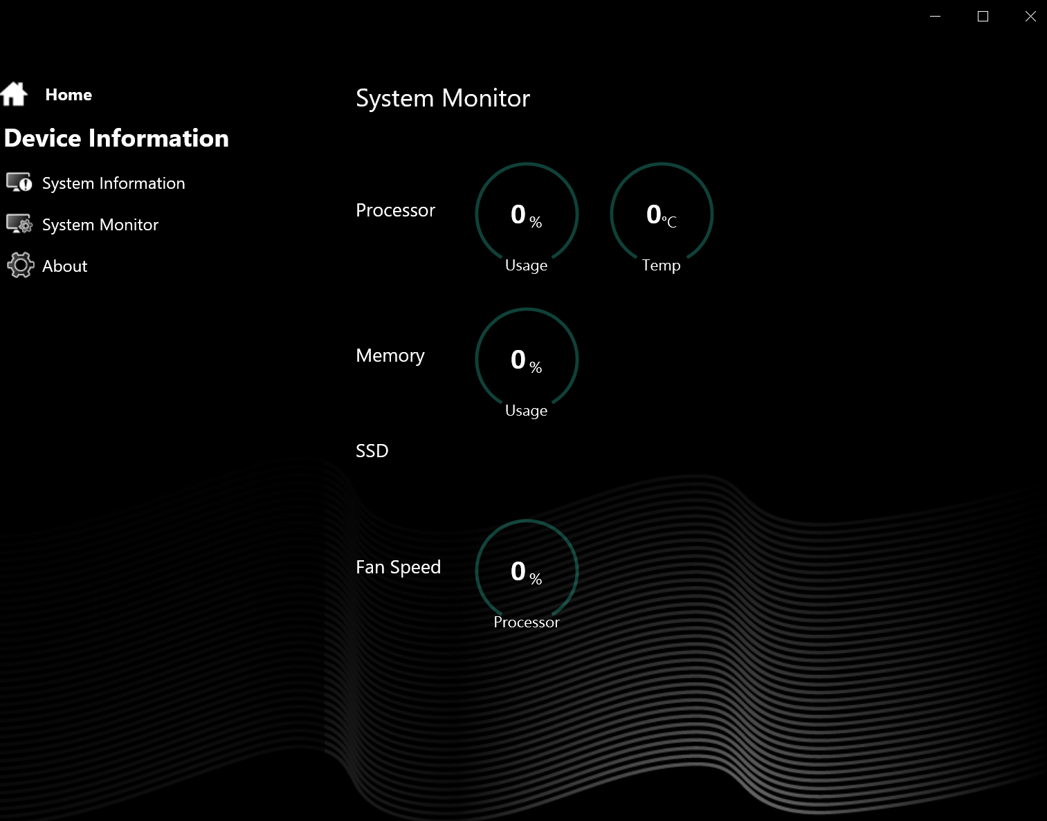

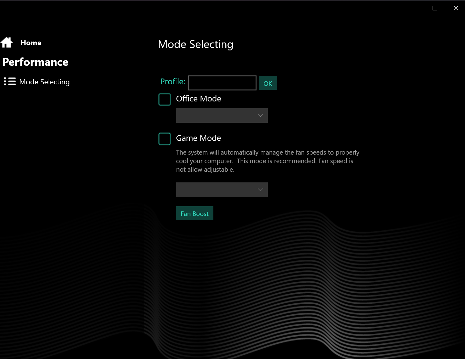

I clean uninstalled CC v18 as @Macco26 mentioned in his youtube video and it worked. Then I downloaded PCS v23 from my download page of PCS web site. Installed, rebooted and guess what? CC totally BROKEN.
Can't select any mode, can't change the lights of keyboard, can't click fan boost, literally can't click nothing on the Control Center. Total blank some options. It's totally broken!
Have you the latest PCS BIOS, that is 1.09 or more recent? Because I knew the latest CC works only with latest PCS BIOS. That includes the v23 from PCS itself, of course.
If that's the case, I don't understand why they publish in our accounts a CC v23 while not the required BIOS (which you have to email them to get).
Feel free to believe it's the v18 creating problems. But if you're still running the 1.07 BIOS or less, be prepared to not having PCS v23 working until you update your PCS BIOS, no matter how many fresh Windows install you do.
