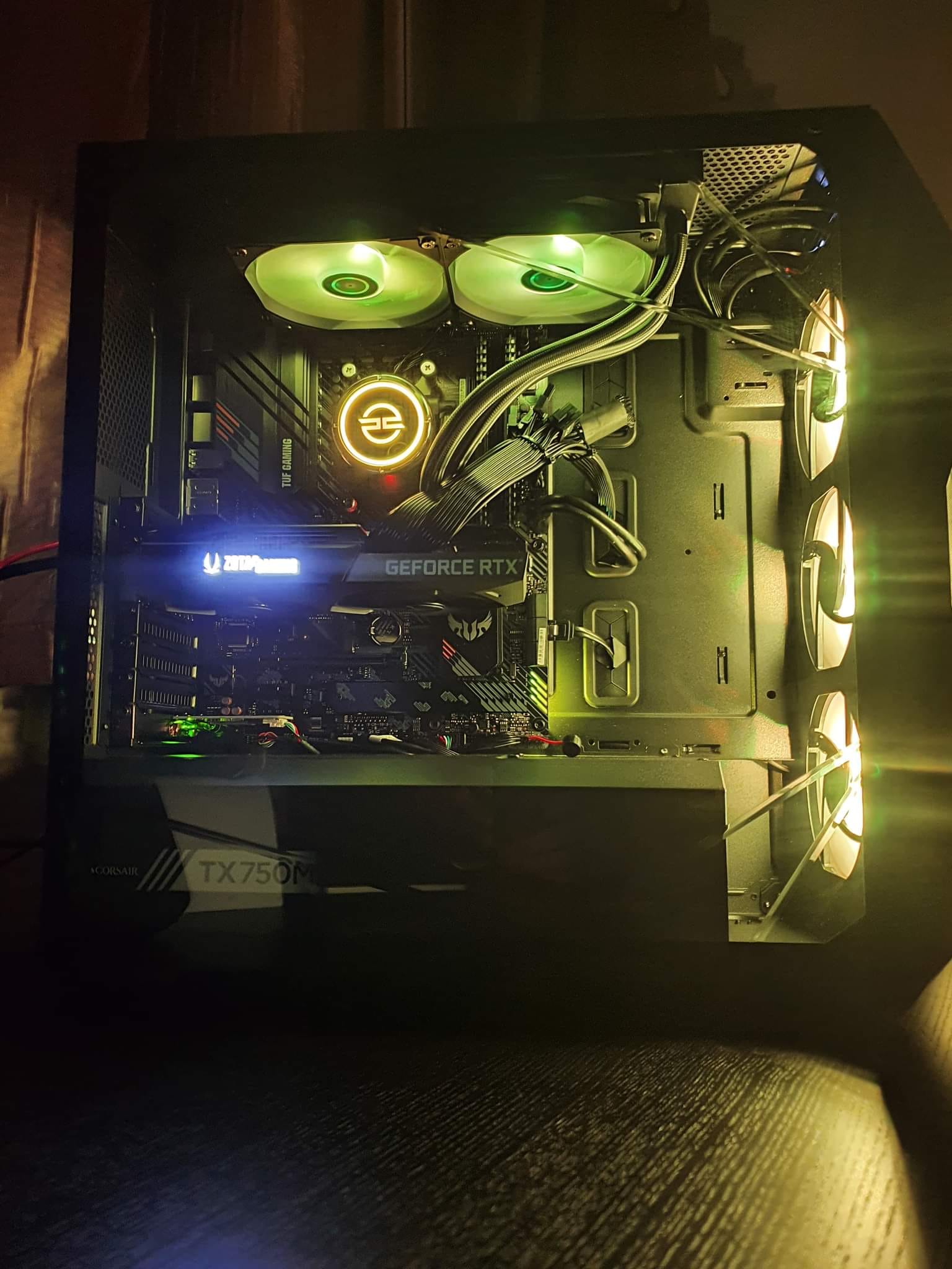

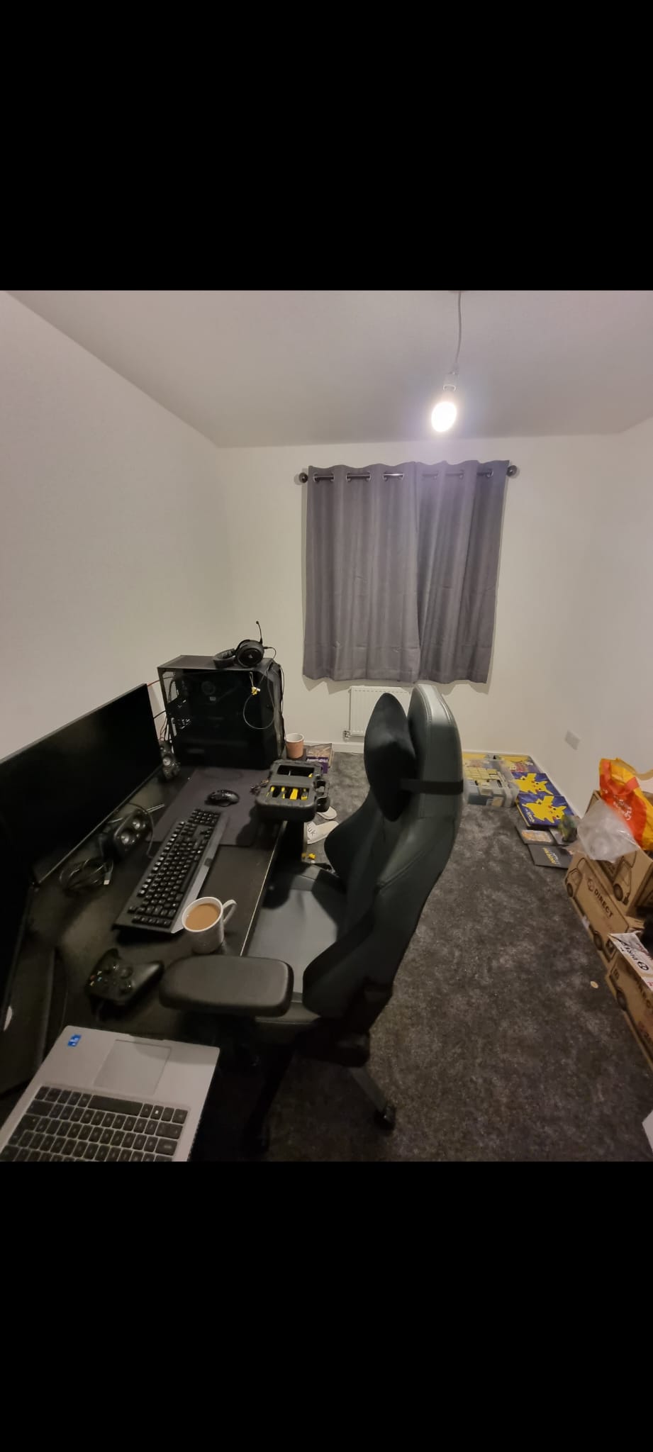

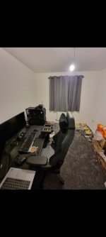

Attached are some images of the PC setup in the new and old house so you can get an idea of airflow etc, (not the best pics as PCS have the system at the minute but its always been kept on a desk, with sufficient flow etc.

Looks clean to me (although not the best pics as you say), so I doubt dust is a factor. Another case of poor quality Frostflow AIO? We've seen a few people report failure before. I'd see if they can change for the Corsair H115i instead, unless you want to try third time lucky with the Frostflow 240?

Yes, I can see that from your room photo. I'd like to say I keep my own office/gaming space as neat, but......
