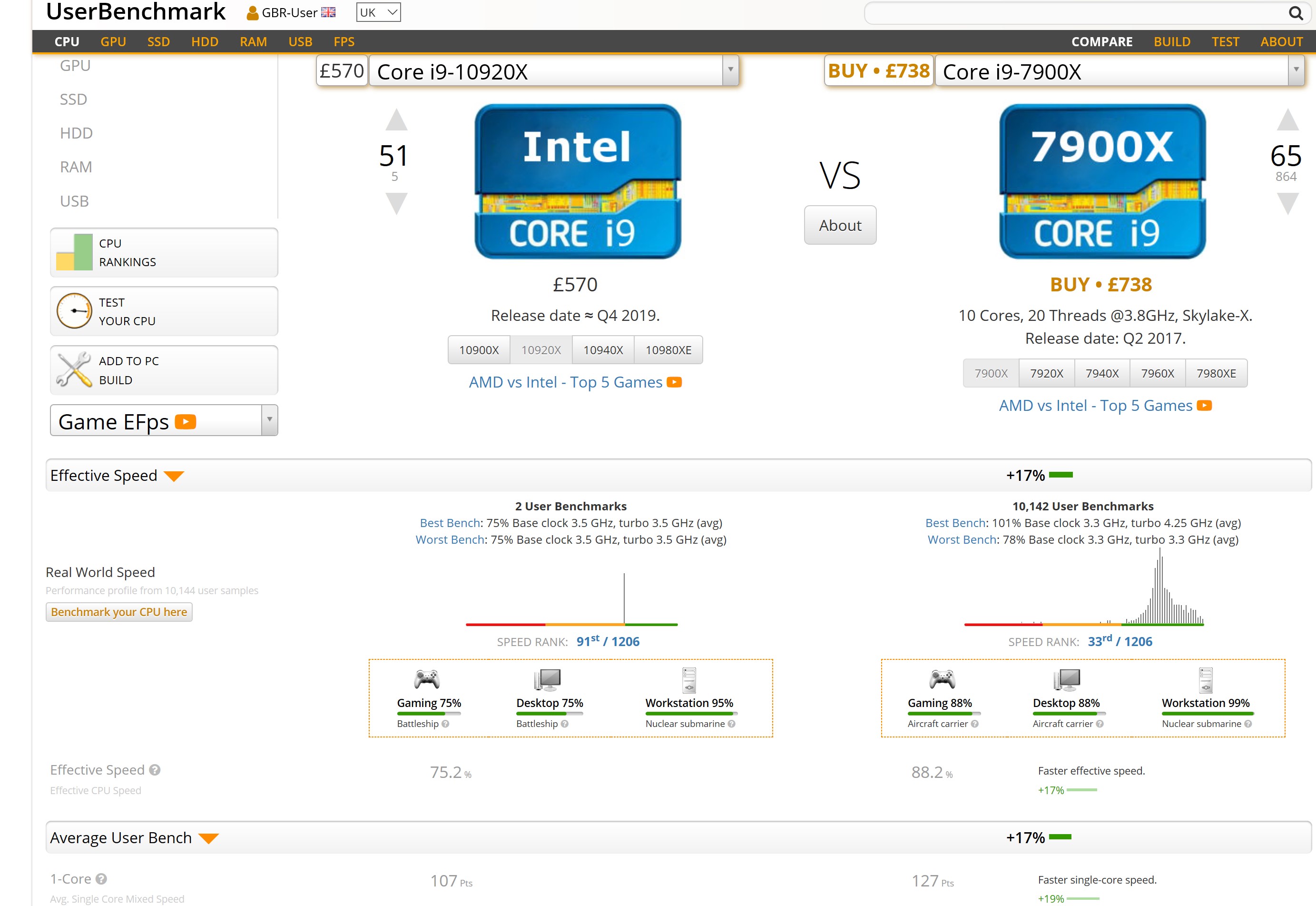

Firstly, don’t use userbenchmark, or cpubenchmark or any of those comparison sites it’s nonsense numbers that have no sense in real world performance, best avoided at all costs.
Neither of those chips are gaming chips, they’re HEDT chips so gaming performance won’t be optimal, but the 10920 is far superior to the 7900x as it’s got a much higher IPC (instructions per clock). The 10920 is 12 core 24 thread And has a higher boost clock of 4.6 vs 4.3, the 7900 is a 10 core 20 thread.
As I said though, neither chip is designed for gaming.

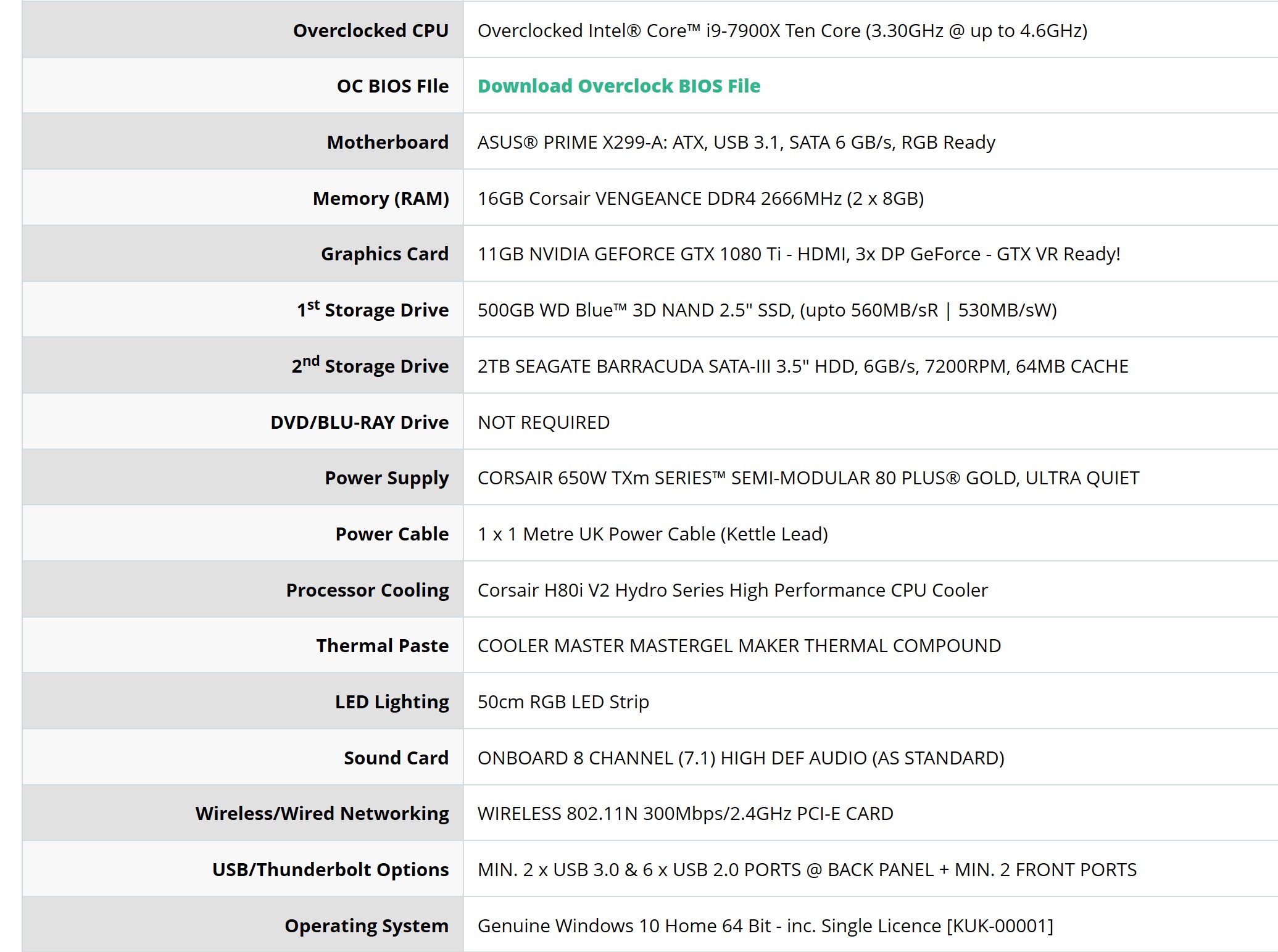

What is the full spec of the system (copied from your order page), what did it cost, and when did you purchase it? (the month and year, anyway).
Tinhead10
Got it only last year and it was having problems after a few months only I was not really aware (fans cycling up and down) which tech tried to fix with bios update until it started powering down. This pc came as a replacement for a previous failed PC specialist computer. PC specialist found it was an uneconomic repair and the added insurance replaced it (not warranty). VERY just rang me to pick the replacement which was on their site £2750 or around that. The other guy saying this is not really a gaming PC! Thanks for taking a look at this as I really have not a clue. This has caused me to spend hours on youtube and elsewhere trying to get this sorted!

I only have the results of the original rig tests on userbenchmark as my guide. Some people don't appear to rate them but for me it will what were the numbers before and after your replacement. You have the unit as was so feel free to run the exact same tests and post the results so that I and all others can see that you have complied with the warranty conditions. The technical gobbly goog isn't going to do it for me but the results will confirm and sell me on your replacement. Can we get this done today please as this has been ongoing for months and both I and the kids would like something to play with over Christmas!

1) Userbenchmark & automated comparison sites like GPUboss, CPUboss, Game Debate etc are garbage as above.
If these are ever correct, it's only like a broken clock being right twice a day is.
Even the price for the 10920x is ridiculous. It's a good £700, not 570. I just checked and it's because it found the part on an American store for $750 and translated that to £570. American prices don't include VAT, so add ~20% to the 570 and you're already at almost £700. Plus American hardware is often a little cheaper too, or at least was before the Trump tariffs. If you see a price in USD you can often assume a 1:1 ratio to the price in GBP. If you spend time on UK tech sites it doesn't take long to hear about the so-called "1:1 exchange rate" concerning consumer tech / PC parts.
2) The suggested CPU replacement is a better CPU than your existing one. It has 2 more cores, and faster frequencies. PCS can certainly say they are living up to the promise of offering an equal or better part if they can't source the original one. If your uses actually harnessed that power it would be a very nice upgrade. You wouldn't see much performance difference in most gaming, but it's still a much better CPU.
3) Also relating to the pricing, Intel recently cut the prices of its HEDT CPUs (the 7900x and all its many brothers and sisters) in half. Essentially because AMD released Zen 2 CPUs that outcompeted Intel to a ridiculous degree. It is likely Intel could always have sold these CPUs for about half the price, but just didn't have any real incentive to do so until AMD released things like the R9 3900x and R9 3950x.
This is why the i9 10920x is both faster and cheaper than the i9 7900x
It has more cores, higher frequencies across the board, more L3 cache... it's a more powerful CPU. And the MSRP is ~$300 (read £300) lower.
NB: we can compare things like frequencies for these CPUs as they are built on essentially the same architecture - but it doesn't work like that across all CPUs as you probably know.
4) @SpyderTracks is of course right that the i9 7900x is not optimal for gaming (neither are any of the HEDT CPUs) because you can get CPUs that are a bit better for gaming for a lower price. These CPUs are a different class of CPU and are available on different families of motherboards.
Nevertheless, the 7900x and the 10920x should 'do' gaming fine. I wouldn't recommend anyone actually buy one just for gaming, but it will still run games, and do so capably.
5)
The price is the standout bit for me. When you got your replacement (and if your original one was also worth about that much money) there'd have been no point spending that much cash just for gaming. £2000-£2250 maybe tops. For an i7 8700k + GTX 1080 ti sort of thing.
Spending more than that will tend to lead people to buying the more expensive HEDT CPUs like the 7900x which aren't really what they're looking for. Unless they're streamers, content creators etc as well of course.
So:
- You didn't buy the best value or best performing CPU / CPU family, but what you got will still do the job
- The i9 10920x PCS offer is a significant upgrade, despite being lower priced than the £1000 7900x.
- Userbenchmark is garbage
