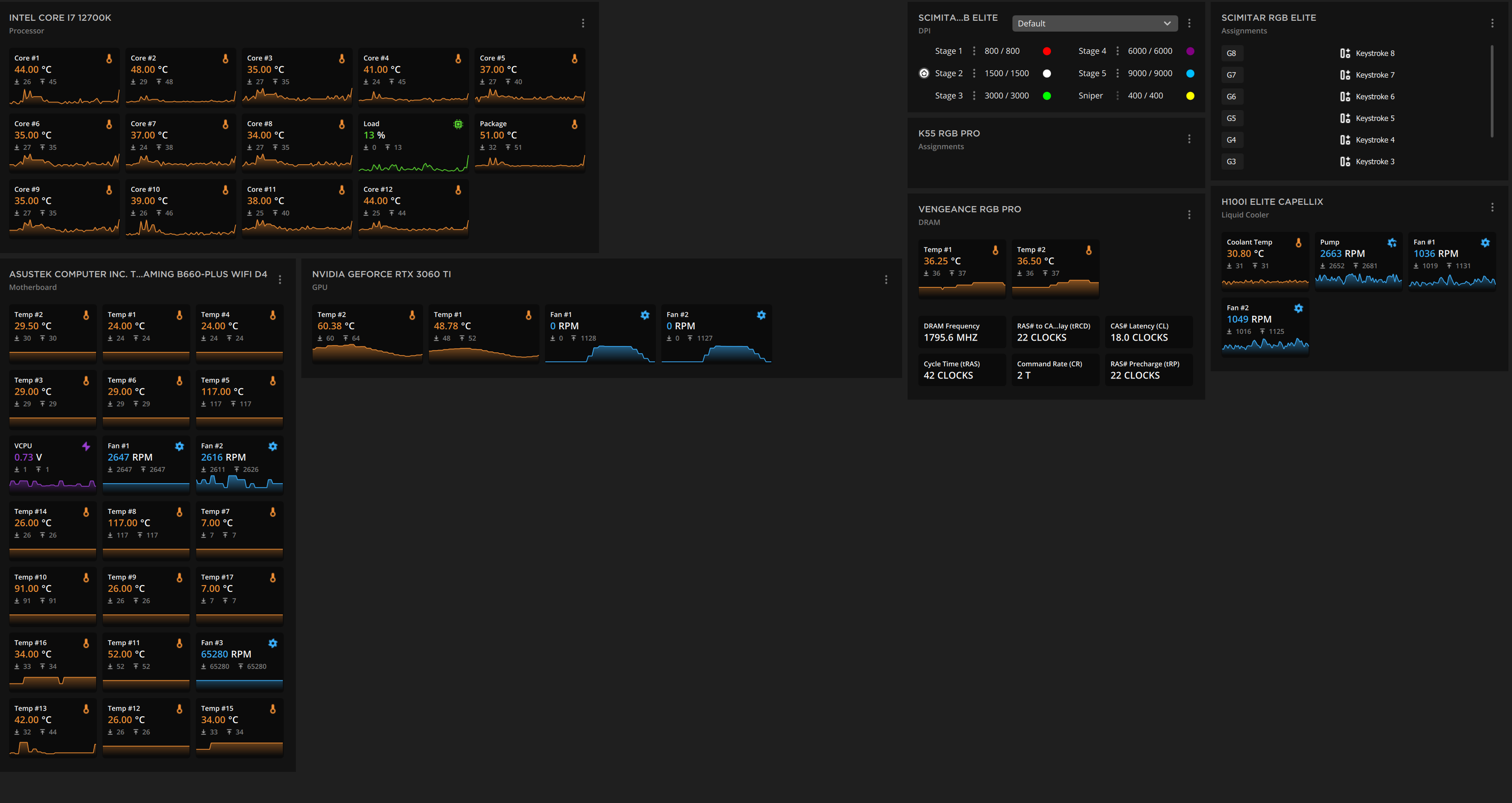

Beege
This is what iCue is showing at the minute, albeit this is not under load as I'm on a break from work.
@Aza is this enough info re: the graphics card?
How would I look to add to the fan curves and amending the voltage to lower the thermals and balance the performance?
B4zookaw
Looking at the H100i fans, they seem quite high RPM for low CPU load. Your GPU fans certainly shot up for a period, but yet GPU never touched 70C. So definitely some tweaking.
Have you pinpointed which fans make the most noise? You should be able to set the H100i to zero RPM in icue to test them, you might have to unplug the case fans (switch power off first!) to isolate them.
