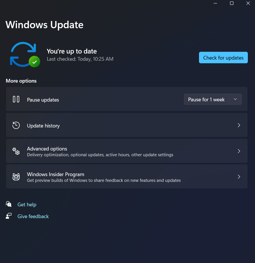

Firstly, have you fully installed windows and drivers after reinstalling? Could you take a screenshot of your windows update and optional updates from advanced options?
here you go (attached)
