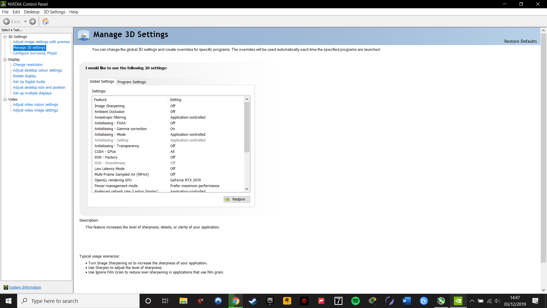

Please help. I have just received my laptop back with a 144hz Gsync display. This is the Vortex Series: 15.6" Matte Full HD 144Hz LED Widescreen (1920x1080) + G-Sync.
After enabling Discrete mode in both bios and 3d control centre, I cannot get the "setup Gsync" option to show. I have used DDU to remove drivers and installed cleanly Geforce experience and nvidia control panel. I have restarted the machine and made sure nothing is running. Nothing I do gives me the option to "setup Gsync". Does anyone have a working solution. I have attached a screenshot of my nvidia control panel below.

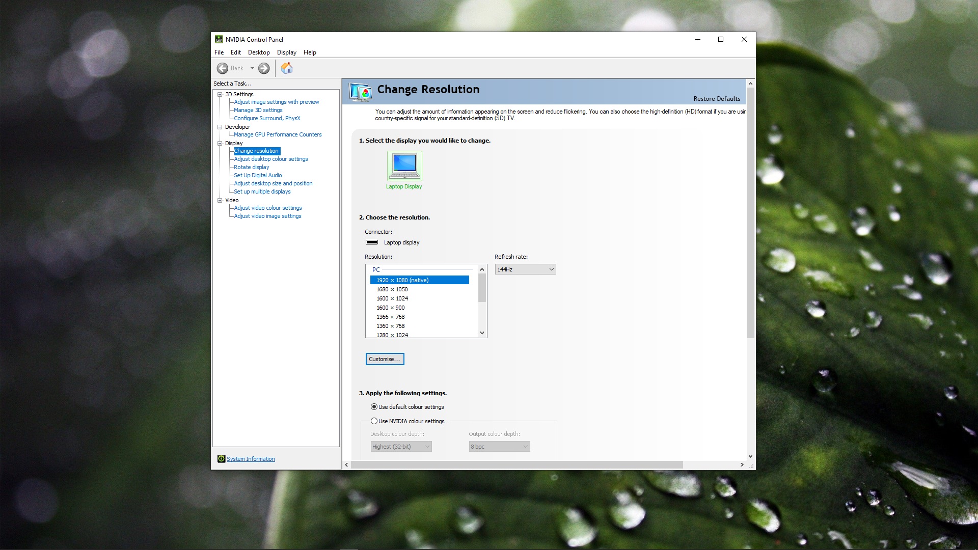

Your problem still exist ?? I have a same problem .... 15.6" Matte Full HD 144Hz G-sync screen but I can't seen the G-sync function in nVidia control panel .

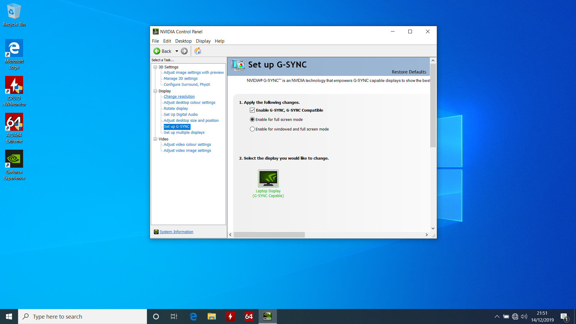

press F2 on boot to enter BIOS settings, change MShybrid option to Discrete - this will mean the laptop will use the NVidia card and you will now have the option in the NVidia control panel to set up Gsync in the display options that were missing before. Not sure how to optimise battery life though...
