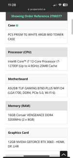

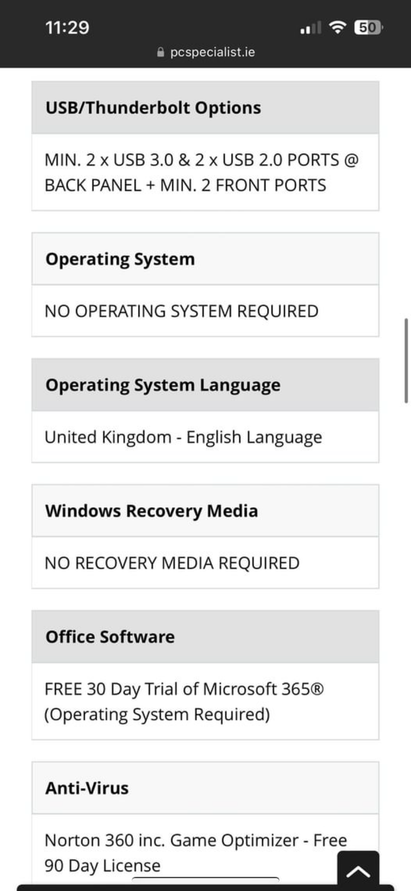

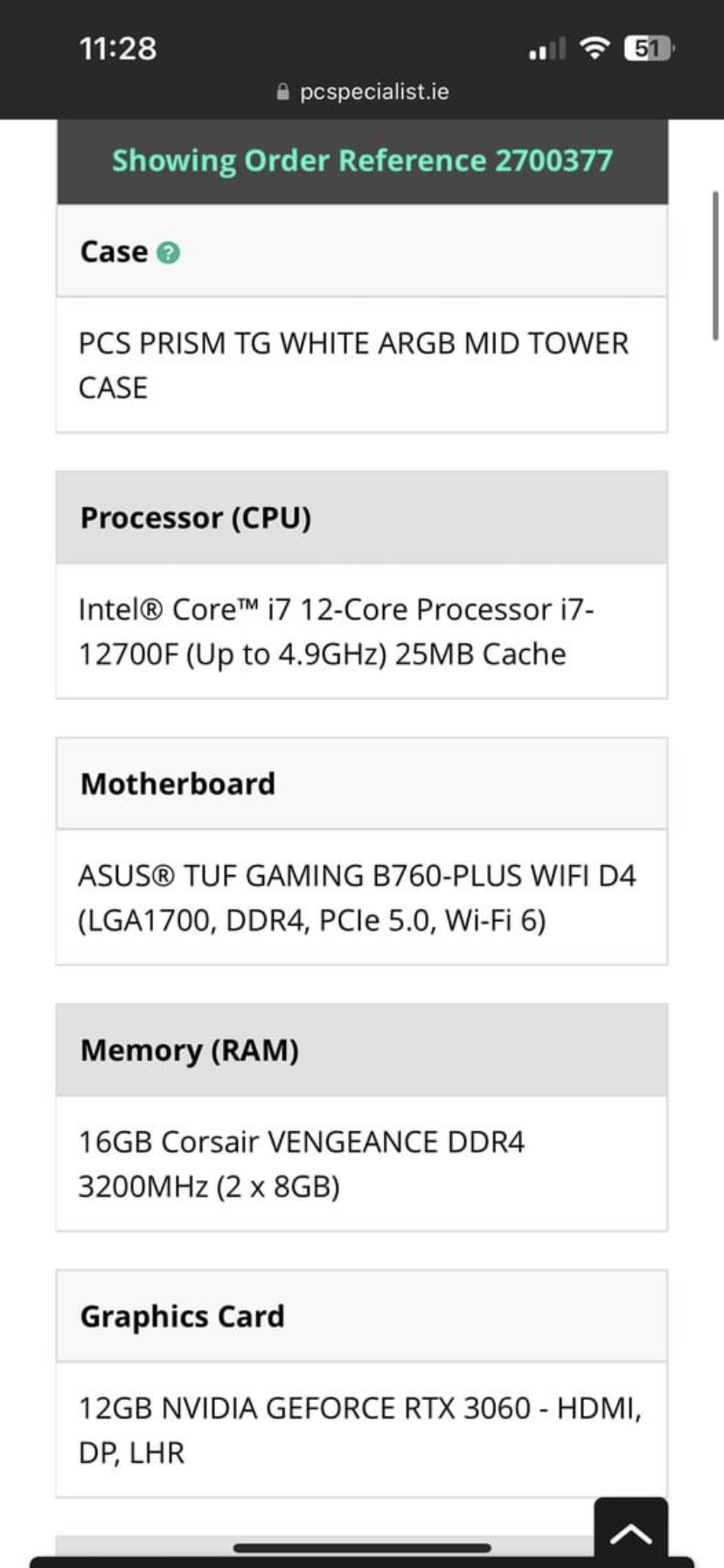

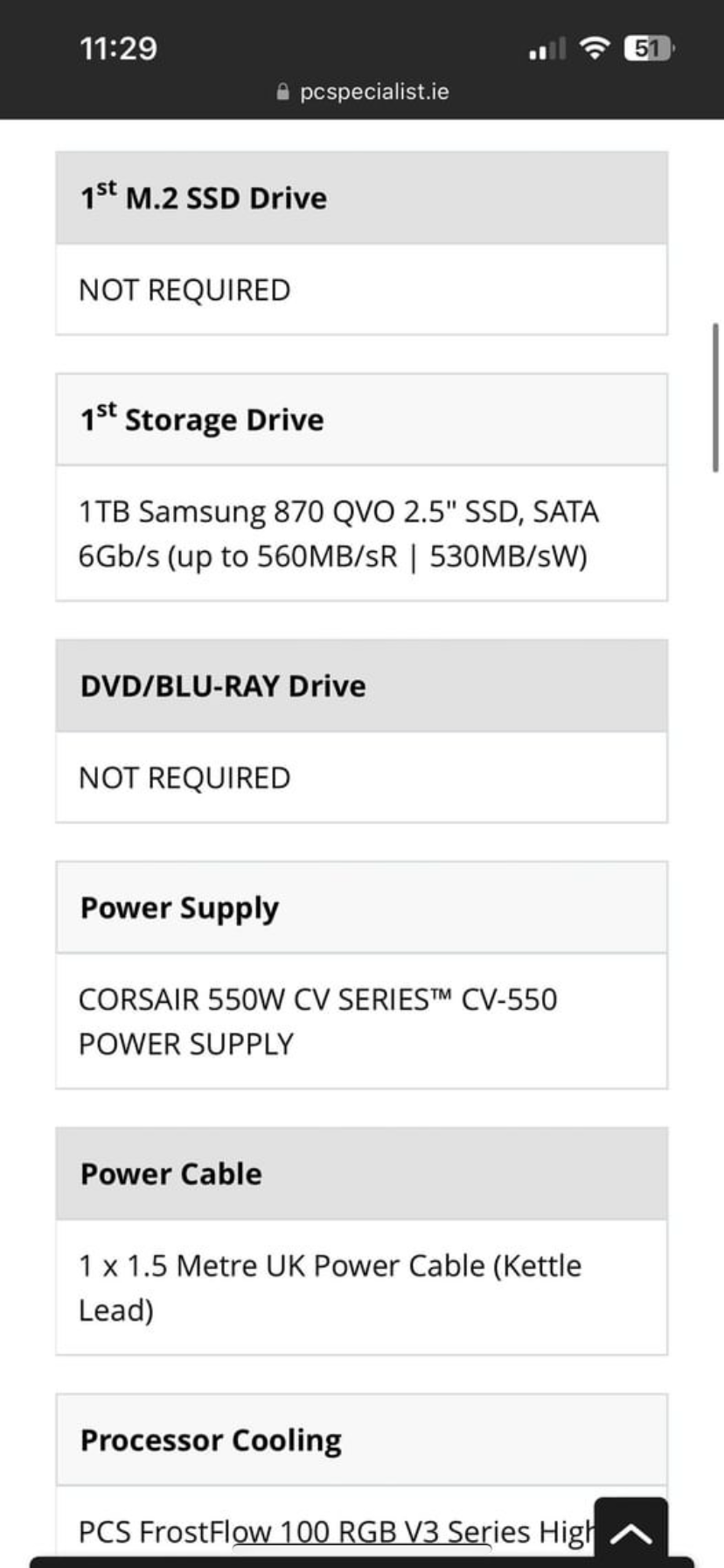

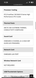

Can you paste the full specs from the order page?
And just to confirm, did you make a windows usb with the latest image from Microsoft?
Ganggang
I did, I got it from the usual page. And sure thing I will post the specs for you

Well it’s hard to say as the symptoms aren’t that clear to be honest.
The green scan lines could point to a graphics driver issue, or a failed gpu.
Would be worth removing the gpu and reinstalling it in case it came loose in shipping.
If the issue persists and especially if you have pixelation before the windows login screen then it suggests a bad gpu.
But I also wouldn’t be happy with that cooler on that cpu.
The PSU is also only just enough for the pc, which shouldn’t attribute to this issue but it’s too low imho when the system is under stress

Software is separate from hardware, it’s not connected at all. If you order without windows you NEED to do a clean install to install your own OS.
PCS also have an open chassis policy on the hardware so you can take it apart and make most upgrades without affecting warranty on the parts you bought so long as you don’t damage them in the meantime

Sorry if this comes across as unpleasant, but what type of upgrade do you think you can pull off on a dead platform with a 550W power supply?
