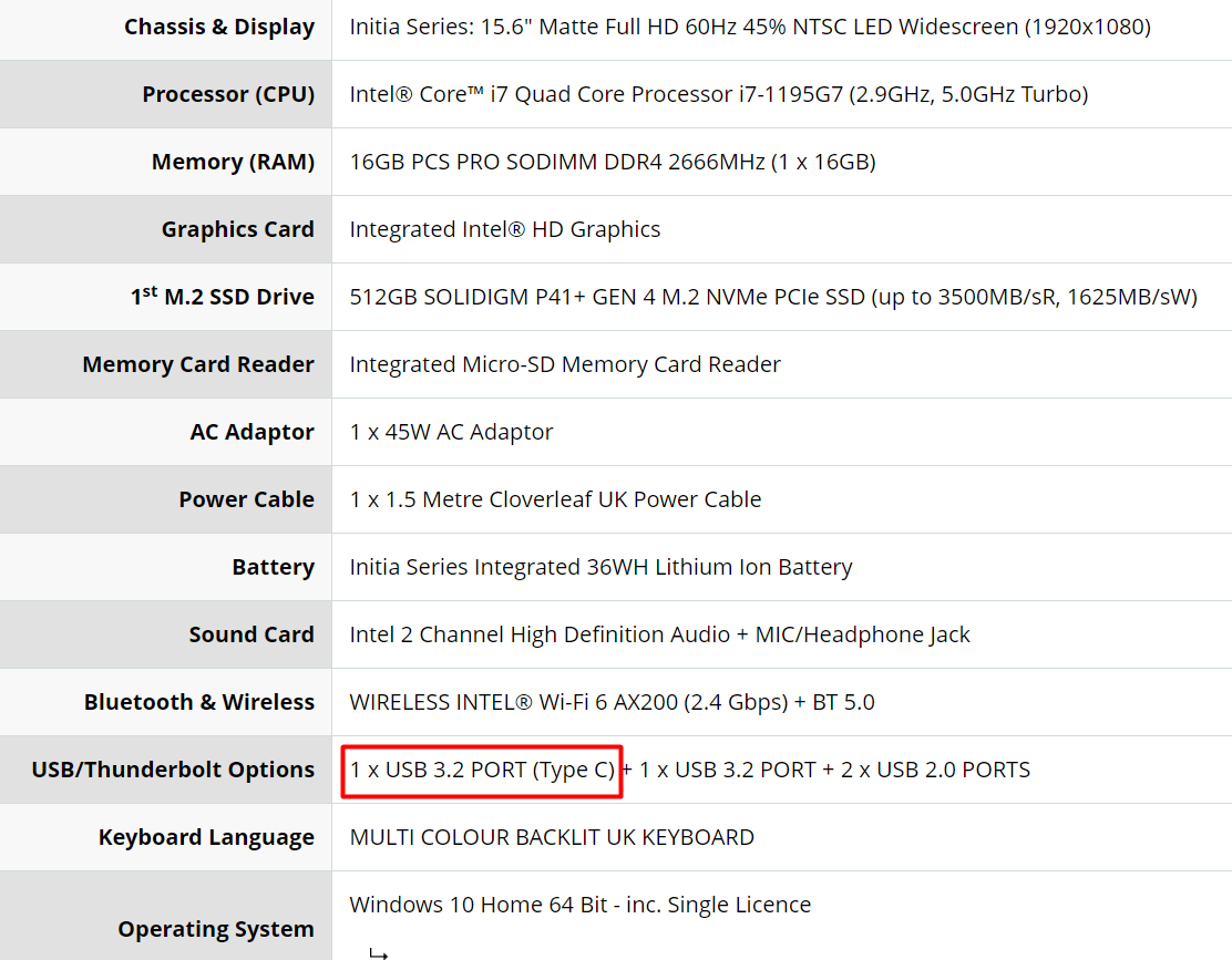

Can you post your full specs from the order page?
It has a couple of USB C ports, only one of which is USB C 3.2, so if you're using the USB C 3.1 port, it's not going to work?
Sperick
Hi,
Here are the specs

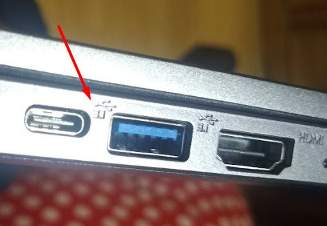

There is only 1 type C port on the laptop so I'm inserting the cable into the correct one
Here is a picture of that port and the red arrow is pointed at the etching that says "3.1"

So there's no mention of power delivery on that USB C port, it would state PD if it had it, so it won't charger via it. USB C doesn't inherently mean it outputs power.
Similarly, it's just a standard data port I believe, doesn't carry video, otherwise it would state "DP over USB C"

It's best to confirm this with PCS, there was a switchover with the USB naming convention, so sometimes it's incredibly difficult to know if they're pre switchover or after.
My guess is though that it's a USB 3.2 Gen 2 port which means USB C at 10GB/s just for data (this happens to align with being a 3.1 port before the switchover as per the stamping)
The port you're thinking of I think is Thunderbolt which uses the USB C connector but carries video by default and power delivery.
For the USB C port to do what you're expecting, it would need to be labelled as "USB C 3.2 Gen 2 PD DP over USB"
