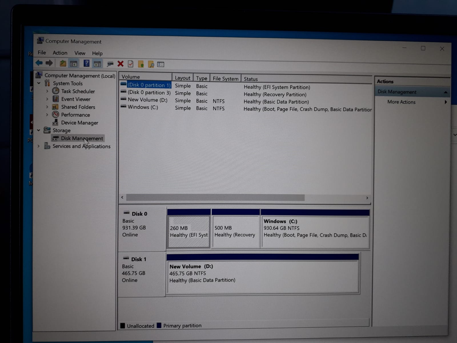

PCS installed windows on the 2nd 1Tb drive and not the 1st 500Gb drive intended for the OS.... grrrrr. I guess they ignored the first drive to go for the fastest... Really want to swap it over but concerned by the efforts Angelo has had. Is it difficult? If not I would prefer to do before adding other stuff.

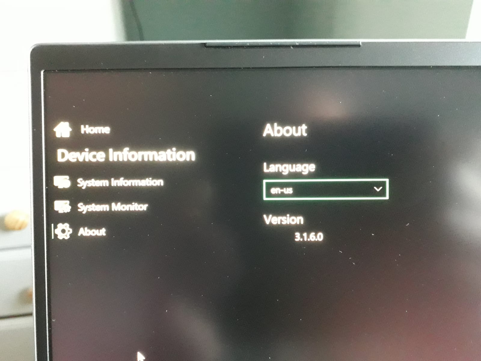

I think I have control centre 3.1.6?
Some pics attached:

Oh and the thermals seem good. Pics attached. Sfc, drives, CC and Firestrike:

2TB drive is faster. That's why they opted for it. You can shrink the partion, adding another and have a total of 3. Like 500 + 500 + 1500 if you want your OS data stay separated by the other.

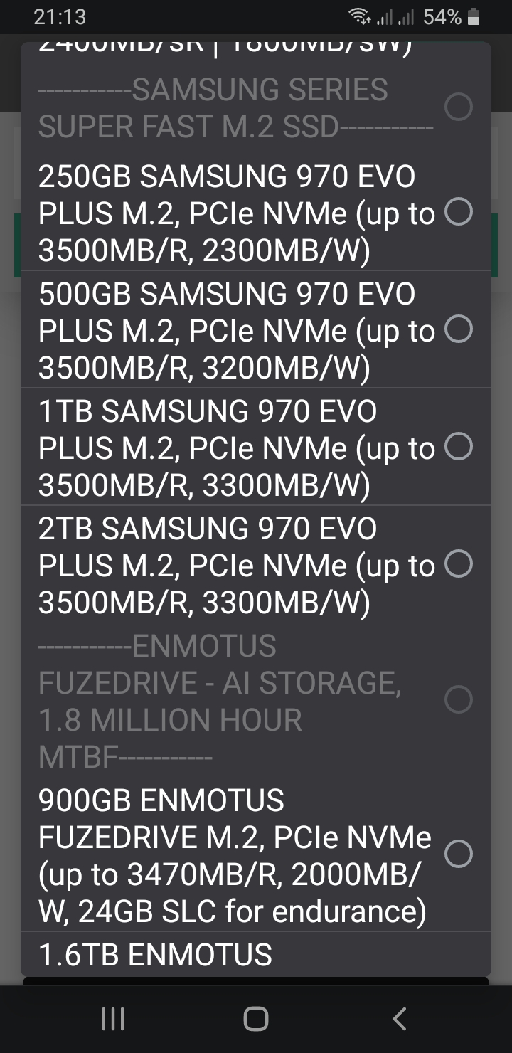

Perfo difference between 500Gb and 1Tb drives is pretty small in attached image (slight write difference of 100MB/W)

You can try with Macrium Reflect to clone your OS drive and implant in the other one. Then in the BIOS say which has to be your primary disk. Of course anything on the 500 GB SSD would be wiped by the image recovery.
I don't remember if Macrium Reflect can do on-the-fly Cloning. For sure it can OS-image on an USB then you recover on the other disk.

Cloning sounds more complicated. I have a USB recovery. I thought I could do some kind of clean install on the 500gb drive and delete windows off the 1tb drive?
Macrium Reflect is free and not that hard, really.
If you want to install windows on the other drive you better open the chassis and remove the existing one, just to be sure Windows does not touch it and consider it the one where to store its recovery, MSR partiotions etc.
That's why with Macrium is all way better, as you clone all those partitions at once from one drive to the other.
