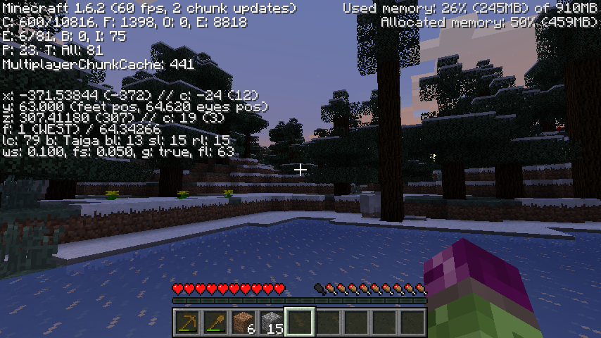

Definitely doesn't sound right. My Optimus V runs Minecraft at a very solid 60FPS (with vsync enabled, much higher without).

Have you manually enabled the Nvidia card for minecraft? I think it is likely to default run the intel HD graphics if you have not, which could be the reason for your low fps. GPU-z would be a good monitor for this too, get that launched and sit in the background and ensure you enable the data to save to a log file so you can monitor it. If it is using the nvidia card you should get some changes in clock speeds and temps for the card in gpu-z.
