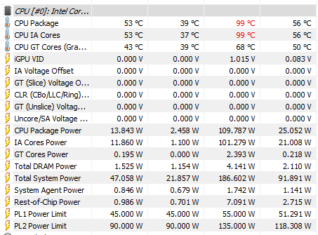

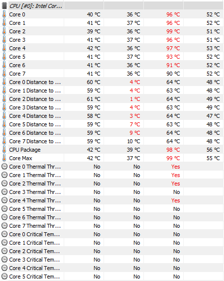

Wanted to check peoples thoughts on my temps. This is a brand new just delivered Elimina 17". My GPU and CPU is running extremely hot to the point that it is throttling the CPU. I used HWinfo64 while playing 1 game of Fortnite and the temps of the package were rather concerning. Is it normal for gaming laptops to push temps this high?
This was using the performance preset and an aggressive custom fan profile that would be running the fans at 100%.

This seems pretty high, especially with 100% fan, and Fortnite not being that big-crunchy-number application for the CPU. Core 2 distance to Tjmax at 1° only is a bit concerning. What about those same parameters but with a less powerful profile?
If I were you I'd contact PCS and see if they suspect a bad thermal paste application from their own. Even because other Eliminas, you've seen, aren't acting so badly so it might be the only differentiating factor among the two.

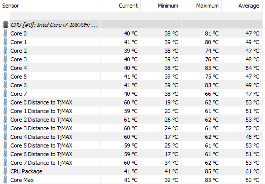

Received my laptop back today, just 4 days after PCS received it so pretty good service I think. They confirmed the issue was a bad thermal paste application. They've repasted it and now temps are under control. They still get quite high - in the 80s - but level off before getting into the 90s even on performance mode.
barlew
In the 80's is exactly what you would expect so that's good.
Excellent turn around from PCS as well, its a shame it had to happen in the first place though.
