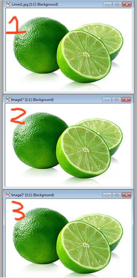

I've noticed that my monitor brightness (Samsung Syncmaster SA450 24") is lighter at the bottom. See the photo of the limes numbered 1, 2 & 3.
Lime number 1 is slightly darker to lime number 3.
Is there any solutions to this brightness problem?

Unfortunately this is the problem with TN panel monitors, they have poor viewing angles (even sat infront of them) and they do not have even light spread or colour distribution hence why they are not recommended for any colour critical work or productivity tasks.
Obviously they can still be used for these tasks but they will be inferior to an equivalent IPS panel which are designed to have even light and colour spread.

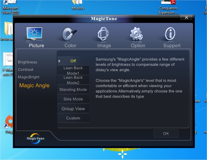

Edit: Saying that, I don't own a Samsung TN panel so I don't know how much help this Magic Angle can be. Could be worth a shot.

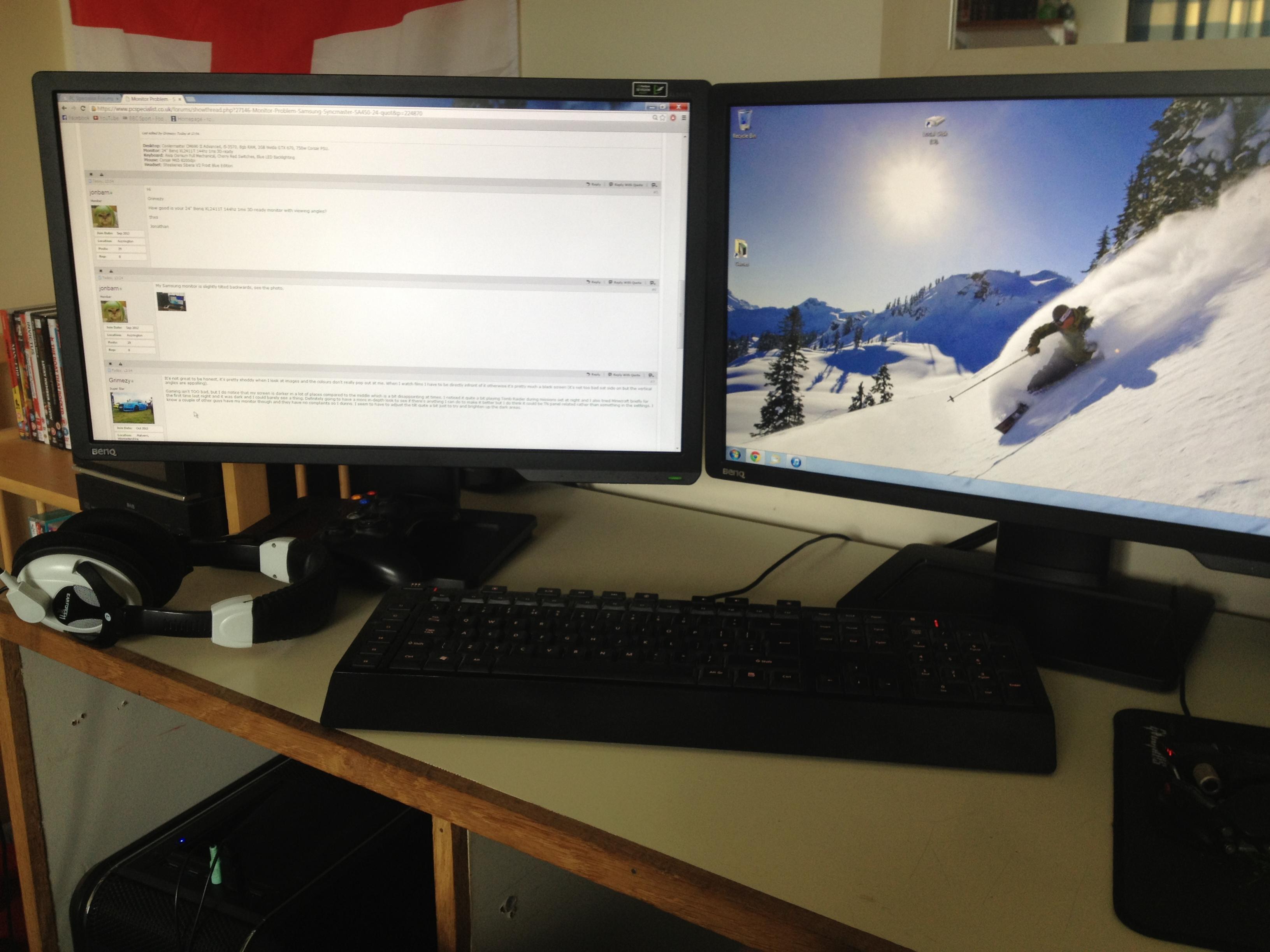

How good is your 24" Benq XL2411T 144hz 1ms 3D-ready monitor with viewing angles?
thxs
Jonathan
Grimezy
Prolific Poster
It's not great to be honest, it's pretty shoddy when I look at images and the colours don't really pop out at me. When I watch films I have to be directly infront of it otherwise it's pretty much a black screen (it's not too bad sat side on but the vertical angles are appalling).
Gaming isn't TOO bad, but I do notice that my screen is darker in a lot of places compared to the middle which is a bit disappointing at times. I noticed it quite a bit playing Tomb Raider during missions set at night and I also tried Minecraft briefly for the first time last night and it was dark and I could barely see a thing. Definitely going to have a more in-depth look to see if there's anything I can do to make it better but I do think it could be TN panel related rather than something in the settings. I know a couple of other guys have my monitor though and they have no complaints so I dunno. I seem to have to adjust the tilt quite a bit just to try and brighten up the dark areas.

mautal
I got the S24C450B a few weeks ago and tend to use the "standing up" setting, even when sitting down, and tilt the screen forwards/downwards or upwards/backwards to suit where I am. That can mean also increasing or reducing the height of the stem(?) stalk thingy. Or are you saying that the monitor was good but has deteriorated in the time you've had it? Me not clever enough to understand how parts of the screen could fade over time, so I'm out on that. I can see the difference of course in your screen shots but I can get mine to do that just by tilting the screen.
