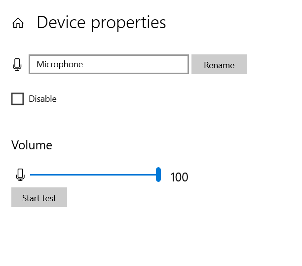

Are you sure it's not just the volume turned down?
InTheMood
Yeap, it's maxed out in Windows' setting.

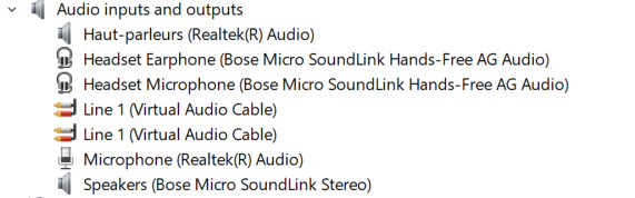

Have you tried the troubleshoot?
Go into Device Manager and under Audio Inputs and outputs - is it still listed - likely to be Microphone (Realtek High Definition Audio) - any error signs/warning icons on it?
InTheMood
Yes as I said in my opening post, troubleshoot is not picking up any errors.
And below is my device manager. Microphone is present and seem to be working. I did uninstall it and restarted to let Windows reinstall the driver, which it did, to no avail.

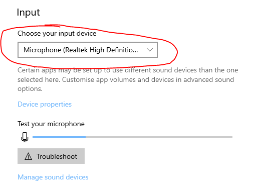

When you open the sound settings what is listed in the Input section:

What is selected as your input device - as shown in my picture above in a previous post?
So when I plug my headset, I can't use the headset mic, it doesn't work (whether it's plugged in the headphone jack or the mic jack). That being said, this headset is very old and I'm not sure the mic works anymore. I don't have another wired headset to try that with.
But that doesn't really bothers me. What does bother me is that whether something is plugged in or not, I can't use the laptop's built-in mic. It behaves as I reported previously, and a pressure around the jack points on the chassis sometimes make it work again, as long as the pressure is held.
Input device selected is always Microphone (Realtek).
