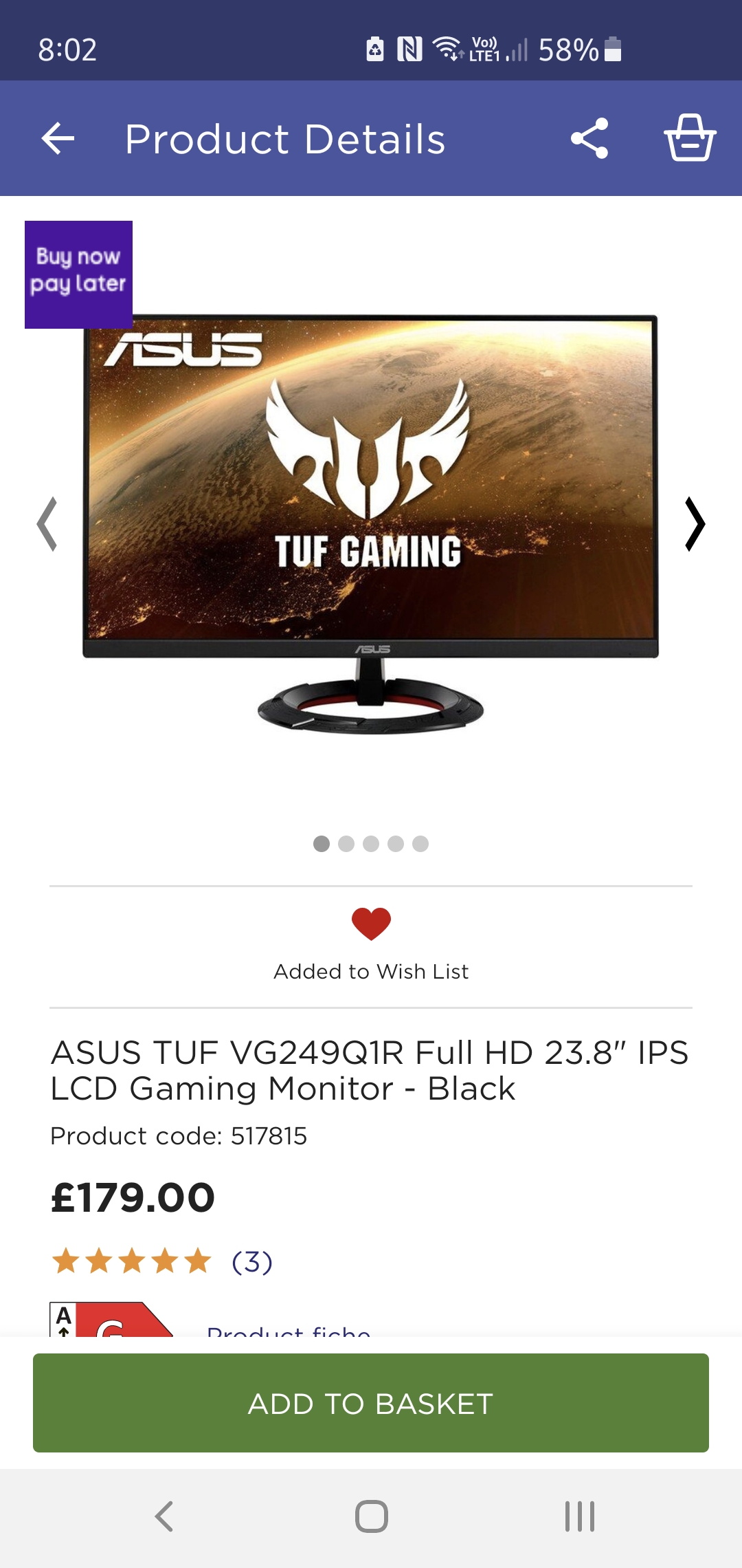

Here is the link:
Please find the monitor I was intending to use attached.

For your monitor you don’t need a 3070. A 2060 would be fine. I would up the size of the Samsung 980 .Pro to 500MB. I don’t think you are likely to need a card for USB ports. I would pick an Intel 670p over the Corsair m.2 due to better write endurance. Is 4TB of HDD necessary?
