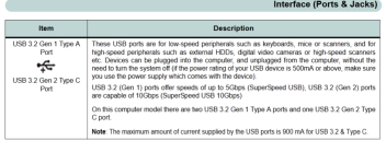

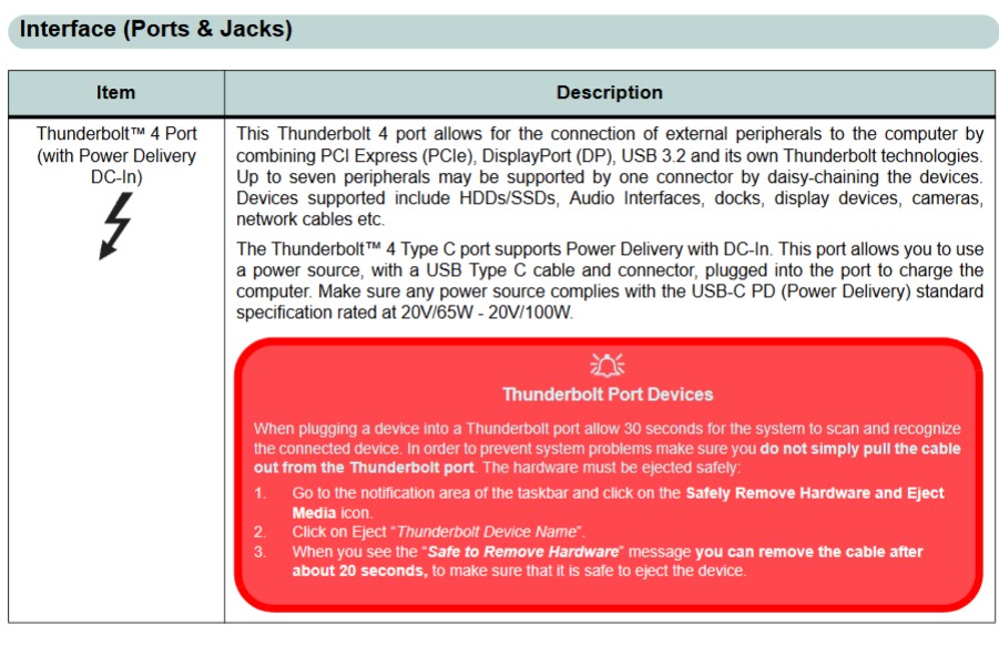

Getting back to your original question and forgetting about hubs, the specifications for USB 3.2 Gen 2 Type C ports and Thunderbolt 4 ports are given in more detail in the downloadable user manual in your user account after you purchase the laptop. That of course does not help you so herewith a couple of attachments.
With the USB 3.2 Gen 2 Type C port, it looks like it is meant only for single devices although I do know it works with a hub provided the devices are self powered. There is no indication that power can be input via this port.
On the other hand, the Thunderbolt4 is much more specific about the delivery of power via this port and the multi use of devices.
So what is the difference I hear you ask, after all, type-c is type-c is type c isn't it ? No it isn't. USB-Type C is a multi pin connection and its uses are defined by which way the pins are connected. To get the Thunderbolt's high data rates of 40 Gbps associated with gaming and fast displays requires high quality cables and connections which incorporate complex electronics. This is why Thunderbolt hubs and cables can be expensive. Somewhere on this forum there is a thread which shows the difference between cheap and expensive conections.
