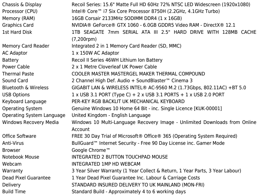

So my laptop has recently been turning itself off whilst I've been gaming. I realise this is most likely an overheating issue but I'm not sure what the best course of action is to fix this? I had opened the laptop up and tried to get as much air into the fans and blow out any dust etc where possible. I also have my laptop on a cooling bed with 3 fans on it but the top part near the screen still gets extremely hot to touch. I was wondering if anyone has any tips or small add on items i could buy to help fix this problem? I've posted my laptop specs below (laptop was bought in 2018) with the addition of a Samsung 970 EVO plus SSD which the laptop now boots from.

Has the thermal paste been replaced at all since you've purchased?
Replacing that would be my first point of call, however i'm sure someone on here more familiar with laptops might have some other ideas :)
A-Mac
I haven't done anything to it since the SSD was installed over a year ago...so I'll try this thanks! Even though I don't have a clue what I'm doing with this, I'll youtube it haha

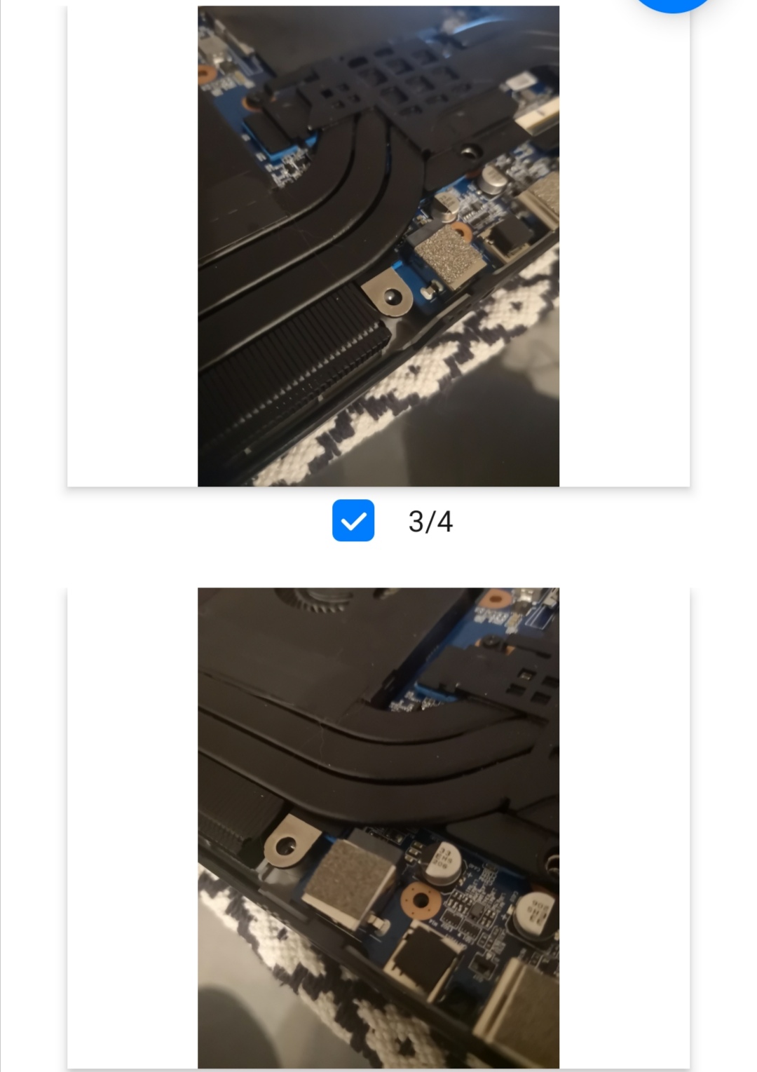

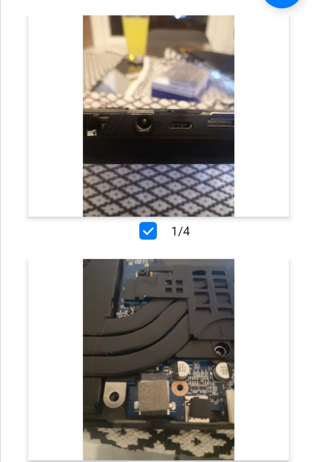

So I've discovered the problem! Unfortunately I'm not sure how to fix it! Basically after getting a new battery and charger and replacing the thermal paste again I've discovered that it is in fact the charging port that isn't working correctly. It only charges at certain angles and I'm not sure what the best way to fix it is? Any ideas? I've attached some pictures of my port for reference...
So I've discovered the problem! Unfortunately I'm not sure how to fix it! Basically after getting a new battery and charger and replacing the thermal paste again I've discovered that it is in fact the charging port that isn't working correctly. It only charges at certain angles and I'm not sure what the best way to fix it is? Any ideas? I've attached some pictures of my port for reference...View attachment 22755View attachment 22756
How would that cause the laptop to turn off?
A-Mac
Sorry that's the after effect of not being able to charge using the port correctly, because it stops charging whilst heavy gaming and it struggles with no power source and eventually turns off, however when I manage to find an angle with he port , it goes back to handling the gaming just fine. Does that make sense? It makes more sense in my head haha

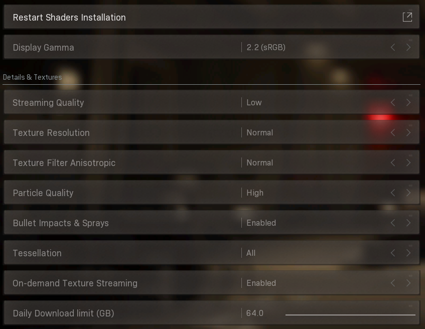

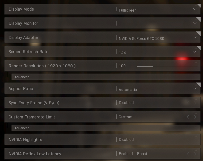

COD setting I am about 70-80fps on Normal (I will try and upload some picture)
I turn everything off that is not needed. I have been looking for a better fan management programme as the bloatware if crap.
(I used to have one stick of ram would avengers(60fps) swapping 16gb 1 stick for 2 8gb made a huge differents)
If you have not already make sure your fans are clean.
Hope this helps abit
josrop
Setting below
